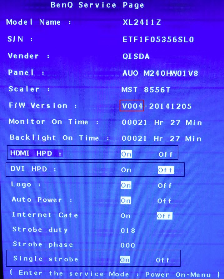

Re: Strobe Utility crashing as soon as I open it
Order it from directly from Benq?whitestar wrote:Hi, I just got this monitor myself, and to my surprise it also seems to be using the V4 firmware:
I'd like to help you guys get the firmware. However, I'm trying to wrap my brain around those instructions. In a nutshell, is it like this:
1. Connect a laptop to the XL2411Z.
2. Install Ubuntu to a USB stick and boot the laptop with it.
3. Dump the fw onto a USB stick using commands in the terminal.
Is that the essence of it? I don't really understand what an i2c bus is though, and I only have a pretty old laptop (at least 6 years).
I might need a fair bit of handholding to get this done.
About BBR on my monitor:
To my eyes it looks really good. When I use Mark's Strobe Utility I use earliest strobe phase (leftmost position) and persistence at 3 or 3.5 when gaming. This puts the crosstalk at about the top 1/5 or 1/6 of the screen when using VT 1500. Which is best I think, as in most games you are on the ground and need the ground to be as ghost/crosstalk free as possible. The crosstalk then happens often in the sky and is not really noticeable.
Now, it IS possible to get an almost perfect screen with just a tiny bit of crosstalk at the bottom. This is done in the service menu on my monitor. If I put Strobe Duty at full (30) and Strobe Phase at about 58 or 59 then I get the absolutely best crosstalk result. BUT, there is a price to pay, and that is reduced brightness. The brightness starts to drop at about 50 and at 58 it's a bit dark (regardless of Strobe Duty value). It kinda reminds me of LightBoost on my old XL2411T actually, but with better colors.
So all in all I actually prefer to just leave the service menu alone and leave the default values there. And just use Mark's excellent Strobe Utility with the values mentioned above. This works really well in most games, especially in games where you are on the ground or in racing games. I have tested Skyrim (at 64hz), Just Cause 2 (at 90hz), Trials Fusion (at 60hz (locked framerate - boooo!!!)) and Assetto Corsa (at 90hz and 100hz).
Very happy with the screen and the BBR.The flicker at 60hz is very noticeable on the desktop on bright backgrounds, and the crosstalk is very noticeable in the UFO test. But both of these are hardly noticeable in the games, which is really nice. It's almost like a CRT only with adjustable hz in steps of one.
You copied his whole post which included the image too o.o
Were you asking if he ordered the monitor directly from Benq, and they blind shipped him a V4 unit brand new?
CorrectFalkentyne wrote:You copied his whole post which included the image too o.o
