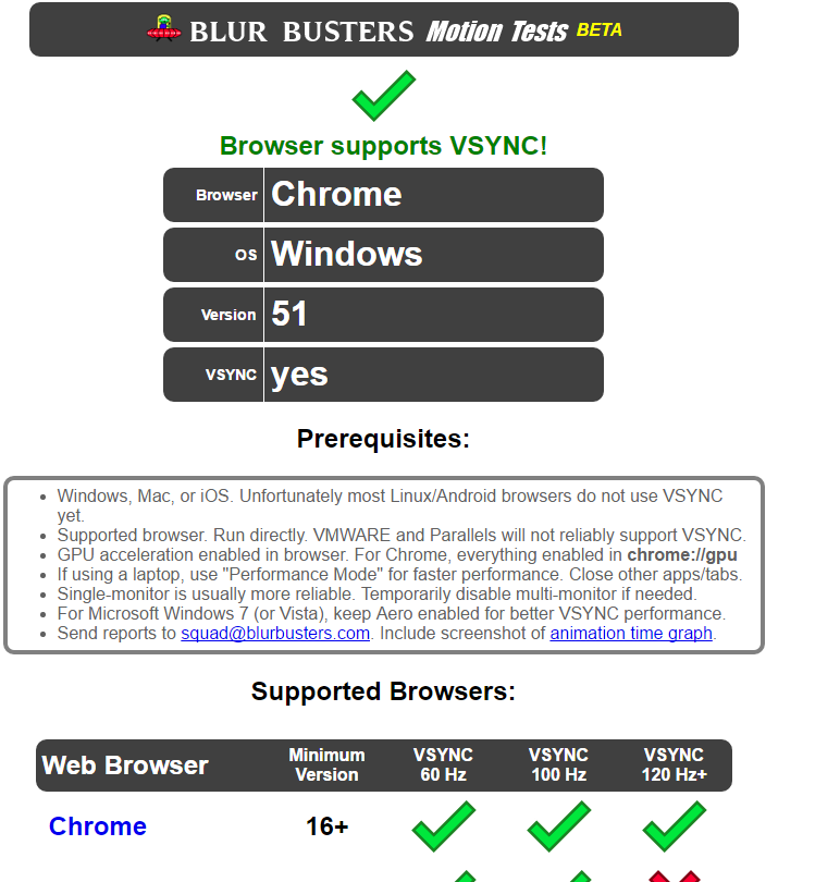

send here screenshot of http://www.testufo.com/browser.html

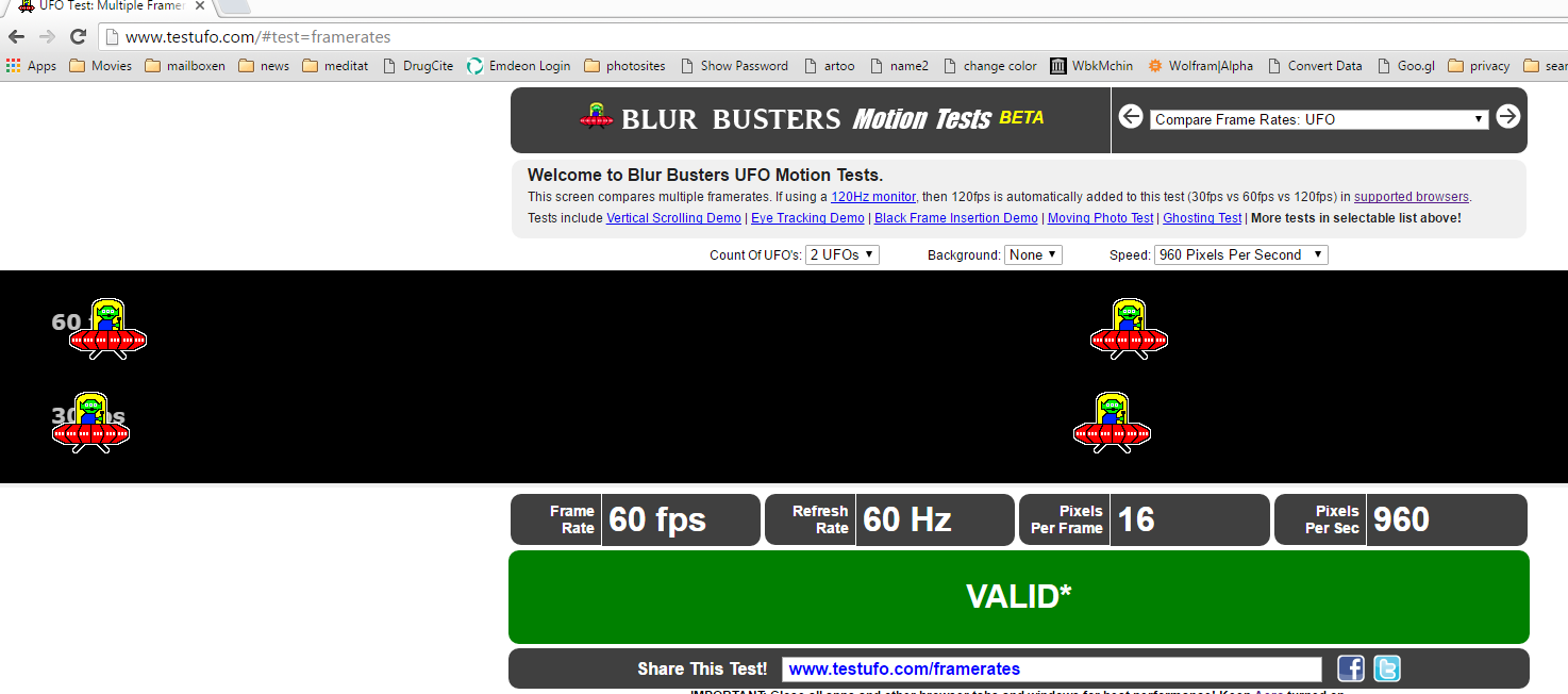

Post by bwana » 21 Jun 2016, 17:09
bbuster test.PNG (80.33 KiB) Viewed 6377 times
as you can see blurbusters thinks this a 60 hz display

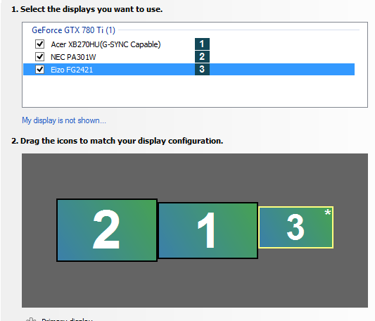

and these are my displays
Falkentyne
Posts: 2805
Joined: 26 Mar 2014, 07:23
Re: BlurBusters not properly reporting Eizo Foris 2421
Post by Falkentyne » 21 Jun 2016, 17:19
Please only use 1 display. Using multiple displays may not work correctly. And Aero and hardware acceleration must be enabled.
bwana
Posts: 19
Joined: 29 Jan 2015, 19:34
Post by bwana » 21 Jun 2016, 17:37
went back and unplugged the other displays. set refresh to 120 hz in nvidia panel. Now it's at 120 hz as expected. thank you.
DanzoMeteor
Posts: 12
Joined: 17 May 2016, 17:19
Post by DanzoMeteor » 30 Jun 2016, 01:41
You can use multiple displays, but NOT in clone mode . If you clone it, the refresh rate is the lowest denominator. I have my 43" m43 c1 Vizio at 60hz and my Hkc X3 at 120hz. No problem!!
