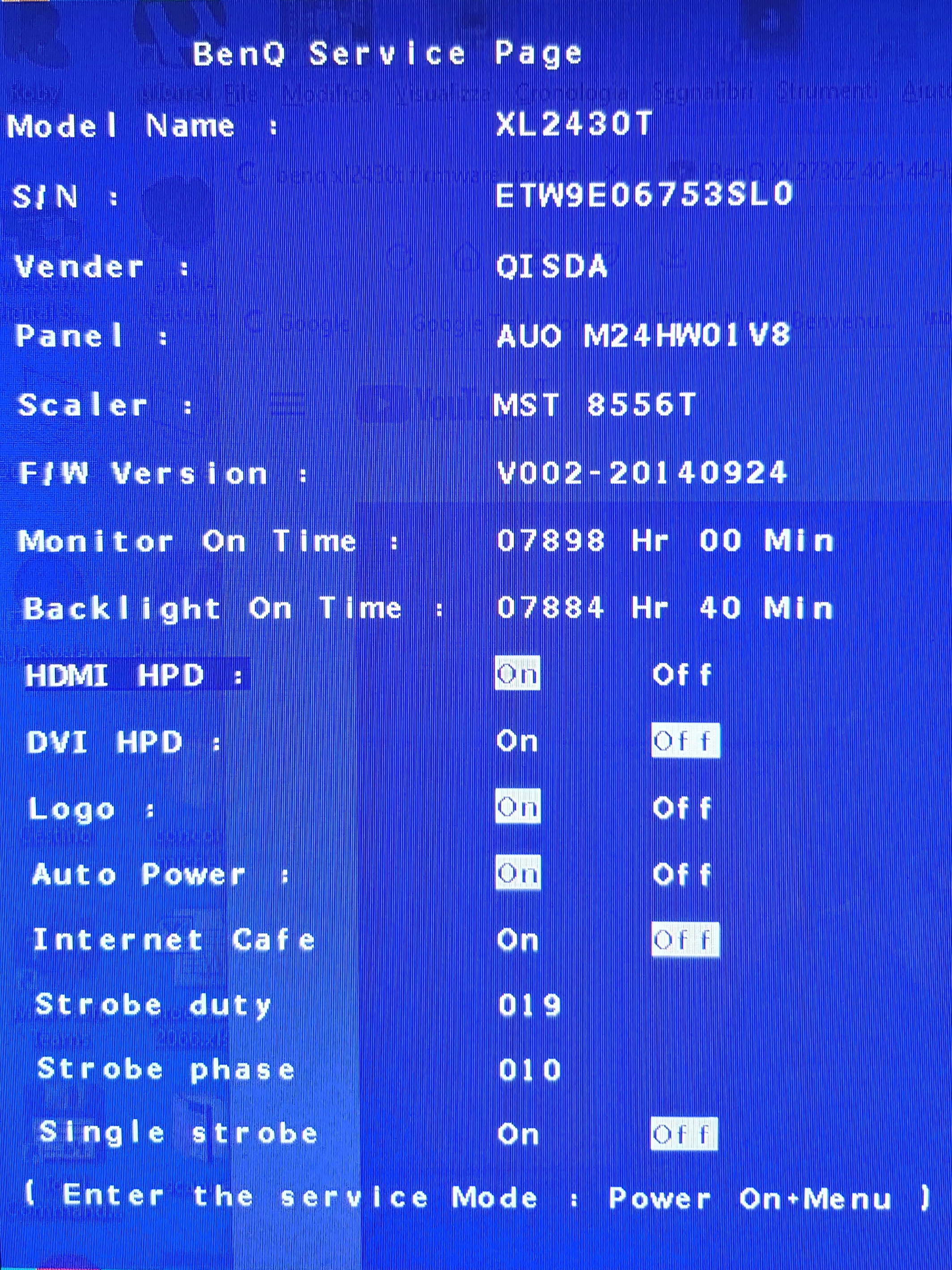

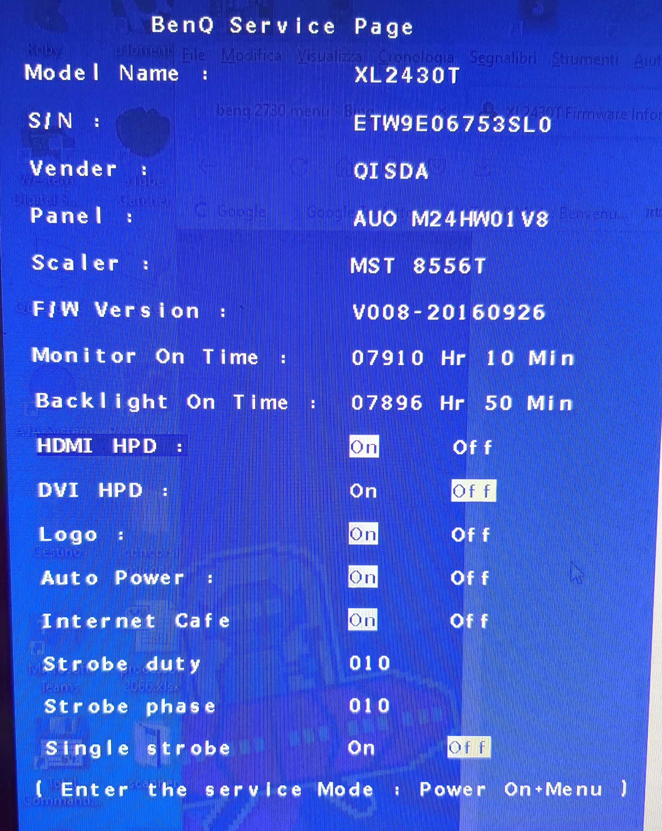

Hi to everybody,
i have just found your forum and i have the problems descibed here...
1) I Can't able to save my profil, and after apply my changes after turn off and turn on my monitor the settings are cleaned !!!
2) Ghost led remaining on after i turn off my monitor.
what is "S-Switch"?
I have upgraded the Benq XL2430T from the Benq center support in Holland,no i have the firmware version 8...Image
And this is the old previous Version 2
new bios ver 8.jpg (2.61 MiB) Viewed 11382 times
old bios ver 2.jpg (2.43 MiB) Viewed 11382 times

You have internet cafe mode on. Turn that off.
