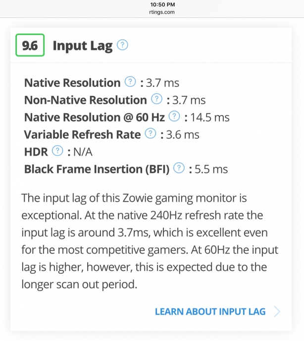

Garbage measurements when they do not even tell you what Hz the lag number is for.
All it says is 240Hz monitors aren't the lowest-60Hz lag.
Many sites only measure 60Hz lag.
Only a few sites including Rtings, BlurBusters, etc truly understand the lag-vs-hz relationships.
For example, RTings measures the XL2540 as being a crappy 15ms....at 60Hz.
But it is a supremely 60Hz-CRT-beating 3.7ms at 240Hz!
(60Hz CRT still is 8-9ms for lag to screen center, as done by common 60Hz lag testers which begin the lag-measuring time measurement from the blanking interval)
Lag numbers with missing Hz numbers = garbage lag measurements unless they tell you Hz numbers too.
What is true, though, is 240Hz monitors aren't the world's lowest lag XboxOne/PlayStation4 monitors, but you aren't going to be using 60Hz timings with these 240Hz monitors. And 60fps@240Hz is lower lag than 60fps@60Hz so even PC-based 60fps (on these monitors) is lower lag than console 60fps.
Q83Ia7ta wrote:Where from you got that bullshit?
Damn right, lag numbers with missing Hz numbers, are all bullshit numbers.
Credit where credit due, many do make a caveat they only measure lag at 60Hz, but many sites omit this critical piece of info!
60Hz lag is NOT the same as 240Hz lag.
That said, 240Hz can be world's lowest lag at highest Hz, while simultaneously, performing worse at 60Hz than the best 60Hz monitors. But big whoop - unless you are doing both PC or console. Who plays CS:GO at 60Hz? :lol:
Chaps2 wrote:Mind your language.
I'm giving this a very rare forum-rules exception.
It's bullshit if Hertz numbers are not attached to lag numbers.
It's like giving you a hard disk benchmark without the brand name of hard disk.
It's like giving you a CPU benchmark without telling you how many gigahertz they benchmarked at.
Lag numbers with missing Hertz numbers are useless numbers, just like that.
Some sites hide the lag Hertz in tiny fine print, some sites don't even mention it at all.
See above image.
