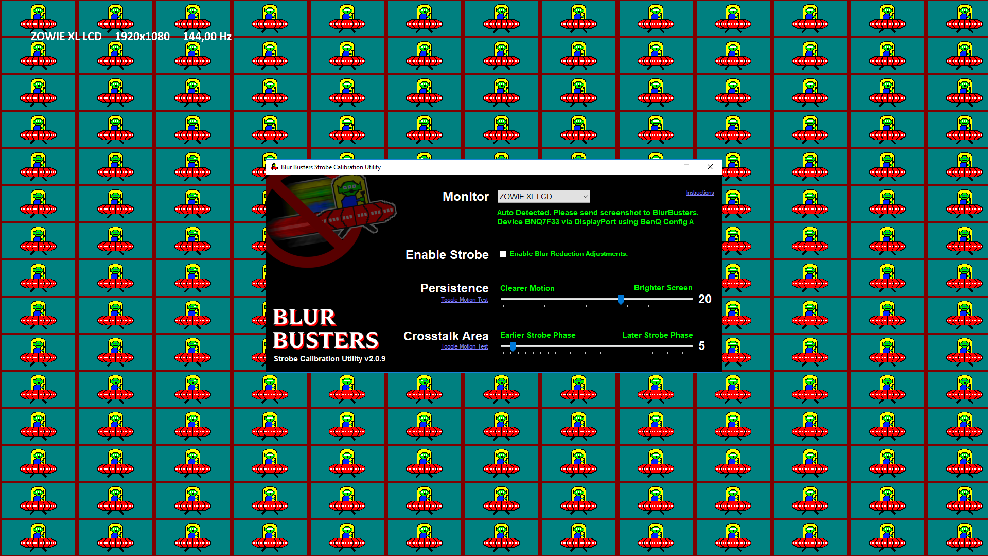

Re: benq photo: Bad Crosstalk at 144 Hz
yeah sure i cant do anything in your program
- bavassvavsavsa.png (201.31 KiB) Viewed 9823 times

- Posts: 12299
Best place to ask questions is here only. Please try to allow 24-48 hours for answers... Thanks!
1. It depends on your goals (blur reduction, VRR, high Hz, etc). No monitor is perfect.
Most blur reduction monitors have strobe crosstalk. It takes some effort to calibrate the strobe crosstalk out of view. See the Strobe Crosstalk FAQ, "Average" is normal for screen center at http://www.blurbusters.com/crosstalk ... "Bad" will often happen at top/bottom edges especially at 144Hz.
2. Before you give up, have you tried the Large Vertical Total tweaks found at the bottom of www.blurbusters.com/strobe-utility ? It really does make a big difference at 120Hz.
This image is the screen center photographed at 120 Hz with the VT1350 tweak. Before/After.
3. Please take a photograph (with smartphone) of your vertical lines. If they are faint 1-pixel-thick vertical lines or checkerboard-texturing pattern, these might be a LCD "inversion artifacts". These are seen/explained in the links at the top of www.testufo.com/inversion .... A small faint amount is normal, but a huge blatantly-in-games visible amount might not be -- but it is extremely hard to benchmark the level of what's abnormal.
