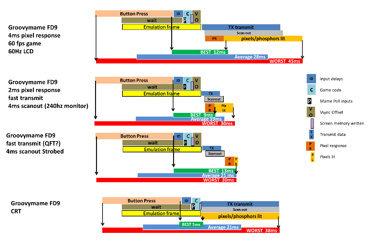

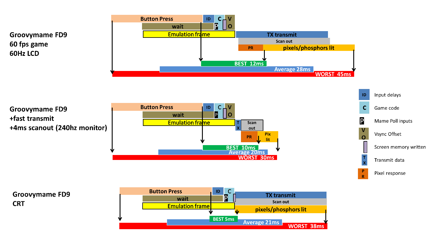

Here's a diagram showing how I understand things and what I'm hoping for. I've incorporated some new to me terminology eg scan out, hopefully correctly.
Hopefully the fact that the performance is better than CRT (and the picture quality closer to CRT) might interest Calamity in making the necessary changes.

You need to create separate diagrams for strobed and non-strobed. The lag gradient is different in the screen's Y dimension.
-- "Scanout" equals "pixels lit" for non-strobed (+GtG response). They're not separate for CRT and lagless LCDs.
While
-- "Pixel lit" occurs practically after "scanout" for strobed.
Excluding cable-lag and GtG-lag, the numbers are:
LCD Non-strobed 60fps @ 60Hz (non-QFT), heavy motion blurring
Top: Add +0ms
Center: Add +8ms
Bottom: Add +16ms
Blur Benchmark: 1/60sec = 16.7ms Persistence (MPRT, not GtG).
LCD Strobed 60fps @ 60Hz (non-QFT), zero blur (CRT-clarity)
Top: Add +16ms
Center: Add +16ms
Bottom: Add +16ms
Blur Benchmark: 1ms strobe flash = 1ms Persistence (MPRT, not GtG)
LCD Non-strobed 60fps @ 1/240sec (e.g. Option 1 of my cost-no-object scenario), heavy motion blurring
Top: Add +0ms
Center: Add +2ms
Bottom: Add +4ms
Strobed 60fps @ 240Hz (when maximizing QFT effect), zero blur (CRT-clarity)
Top: Add +4ms
Center: Add +4ms
Bottom: Add +4ms
(Excludes GtG time)
Anyway, do you now understand how the input lag gradients change during strobed modes? Because you see "scanout" equals "pixel lit" because the scanout is realtime emitting photons (just like a CRT), as the display is scanning top to bottom. Cable lag adds about 1ms and GtG lag adds about 1-2ms. So add both numbers equally to top edge of screen, center of screen, and bottom edge of screen.
So...question is....Do you want strobing or not? Reducing motion blur by over 10x? Getting less than one-tenth the blur of a typical 60Hz LCD? There's a lag penalty for that, but the quick frame delivery effect can massively compensate for that, as you can see above in the "60fps at 60Hz"
Once you decide you want strobing or not, then factor this math into your next diagram. The Y-axis lag gradient of a display changes with scanout velocity, as well as changes with global presentation (whole-flash) versus sequential presentation (CRT scanning).

I forgot about strobe when I was doing the diagram, here's my latest attempt. I've shown the transmit taking 4ms now with the scanout running in parallel with a slight lag. Maybe I can remove VsyncOffset from my pre-vysnc times, I don't understand well enough to know if it's part of the new scheme.
I agree with you on the blur reduction, in the 240Hz examples I am happy to sacrifice 2ms response for 90% blur reduction. In a 60Hz case I would have to see the blur reduction and feel the lag to see if it was worth 8ms average.
I'm not even sure that I'm unhappy with my current system. I really need to redo my back to back testing against ArcadePCD+CRT. What's prompted this research is that I switched to an IPS panel for better side viewing angles when rotated to vertical orientation, but I noticed the lag and blur seemed worse than my older TN panel. Then I started on the quest for just how good could it be...

Re: Is groovymame with 120fps BFI still a good option ?
Thanks for the superinformative post.
frame_1, frame_1, frame_1, black frame, frame_2, frame_2, frame_2, black frame, ...
This should be relatively easy to do in GM. What I need to understand is, do you mean to do this sequence at 240 Hz:Chief Blur Buster wrote: Fastest QFT acceleration I have done is a VBI 3x the size of Active, transmitting a fixed 60Hz signal in a mere 1/240sec. But you can just do the 180Hz trick (for improved software BFI + hardware strobing) to get blur reduction with a hell lot less input lag, if willing to modify emulator source code for this.
This can get confusing. for a layperson, but not for CRU experts. (As long as the emulator has support for 60@180 BFI....not sure if GroovyMame supports odd BFI ratios). I know xash3d author successfully did it, see Area51 forum.
