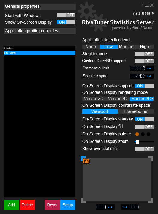

I can't seem to get this to work. I'm using 7.2.0 Beta 4. All I need to do is set "Scanline sync" to a non 0 number right?
Why is it limiting my framerate to 60 when I'm using a refresh rate of 144hz?

Hmmm. Does it run 144fps when scanline sync is turned off?7bhsq wrote:I can't seem to get this to work. I'm using 7.2.0 Beta 4. All I need to do is set "Scanline sync" to a non 0 number right?

The monitor's OSD is displaying 144hz and the ULMB+GSync trick capped at 141 FPS is working as expected. The game I was testing with (Enter the Gungeon) runs at over 300 FPS when uncapped.
