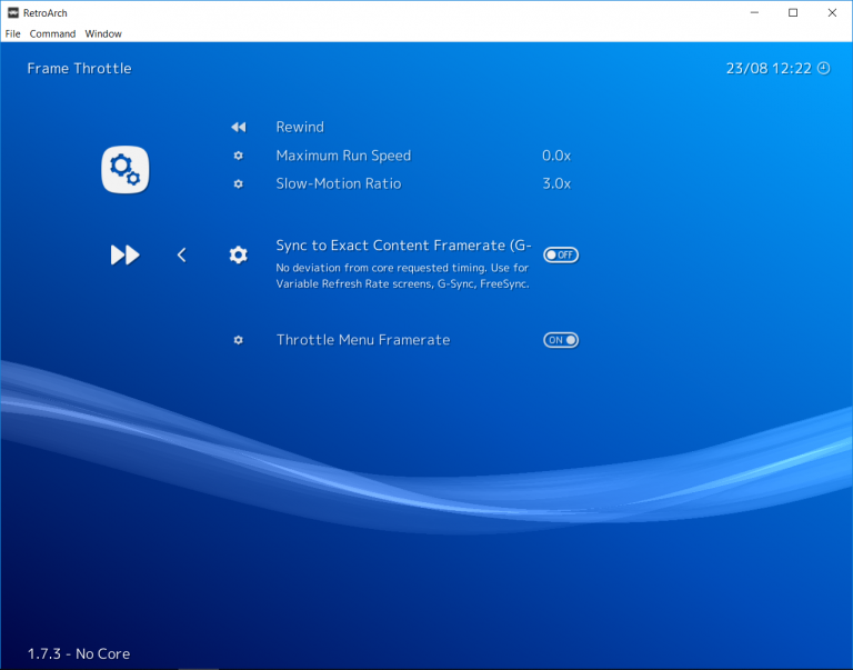

Finally they got g-sync support in retroarch
https://www.libretro.com/index.php/category/g-sync/

- RealNC
- Posts: 4612
- Joined: 24 Dec 2013, 18:32
Re: Loosing my mind with G-Sync & RetroArch stutter
wenarlin wrote:Finally they got g-sync support in retroarch
- Posts: 12266
Yup.
That's the Proper Way to do it. Present the frame at the exact original timing and let the monitor sync to that.
Mind you, the emulator cores need to preserve original frame timings, but fortunately most emulator cores seem to be able to do it (with some core-specific tweaks -- e.g. MAME needs "Enable Throttle")
