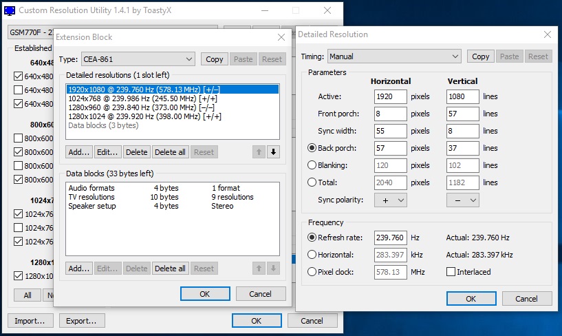

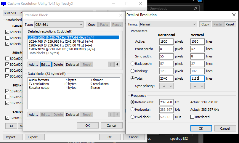

So i followed the instructions on the front page to stop the stuttering and get 239.760hz refresh rate by changing the VT to 1182 from 1180 on CRU. So thats fine and it fixed the stuttering. Now the problem is i am unable to enable G-sync now. I can confirm that this is the issue as i resetted to the stock 239.759hz and went through the process of enabling freesync/g-sync and it works. I know when g-sync is working due to the OSD fluctuation in hz as well as the Nvidia indicator letting me know. With the 239.760hz mod those 2 indications would not be showing. Anyone can confirm that G-sync compatibility gets removed due to the mod? or if there is a fix for this?
Can confirm, that it is working fine for me.
Actually tell me more about how you actually used CRU.
You should use an extension block.
Meanwhile this will show as a default resolution, as seen in my Screenshot.
Screenshot (164)-min.jpg (230.86 KiB) Viewed 9184 times

Post by Romiyo » 04 Apr 2019, 10:06
addi wrote:
Romiyo wrote:Hi all,
Thanks for the reply, I am no expert on CRU but I simply went there to edit the extension block of monitor on the 1920:1080 res where i click on the "total" parameters and changed the Vertical lines to 1182, OK, closed and then clicked on the restart 64.exe. I thought this was following the instuctions as given on the front page. Should i do something else?
EDIT: I went back and changed the back porch values instead to like exactly how it was done in the first page example, where it also settled on the 239.760hz number. Still no luck on getting G-sync to work.

Post by addi » 04 Apr 2019, 11:04
Romiyo wrote: Thanks for the reply, I am no expert on CRU but I simply went there to edit the extension block of monitor on the 1920:1080 res where i click on the "total" parameters and changed the Vertical lines to 1182, OK, closed and then clicked on the restart 64.exe. I thought this was following the instuctions as given on the front page. Should i do something else?
Do you own a gtx 10xx Card with more than one displayport output ?
Might aswell try to change the displayport.
Had problems activating G-Sync, just one out of the 3 displayports was actually working.
Never thought even about, that this issue is due to the 1082 VT.
I don't really want to check, if this is actually the case, but you can try :)
Edit: My settings are the same, as yours in CRU.
Just the "MHz" is slightly different, even tho we are using the exact same values.
Shouldnt make a difference anyway.

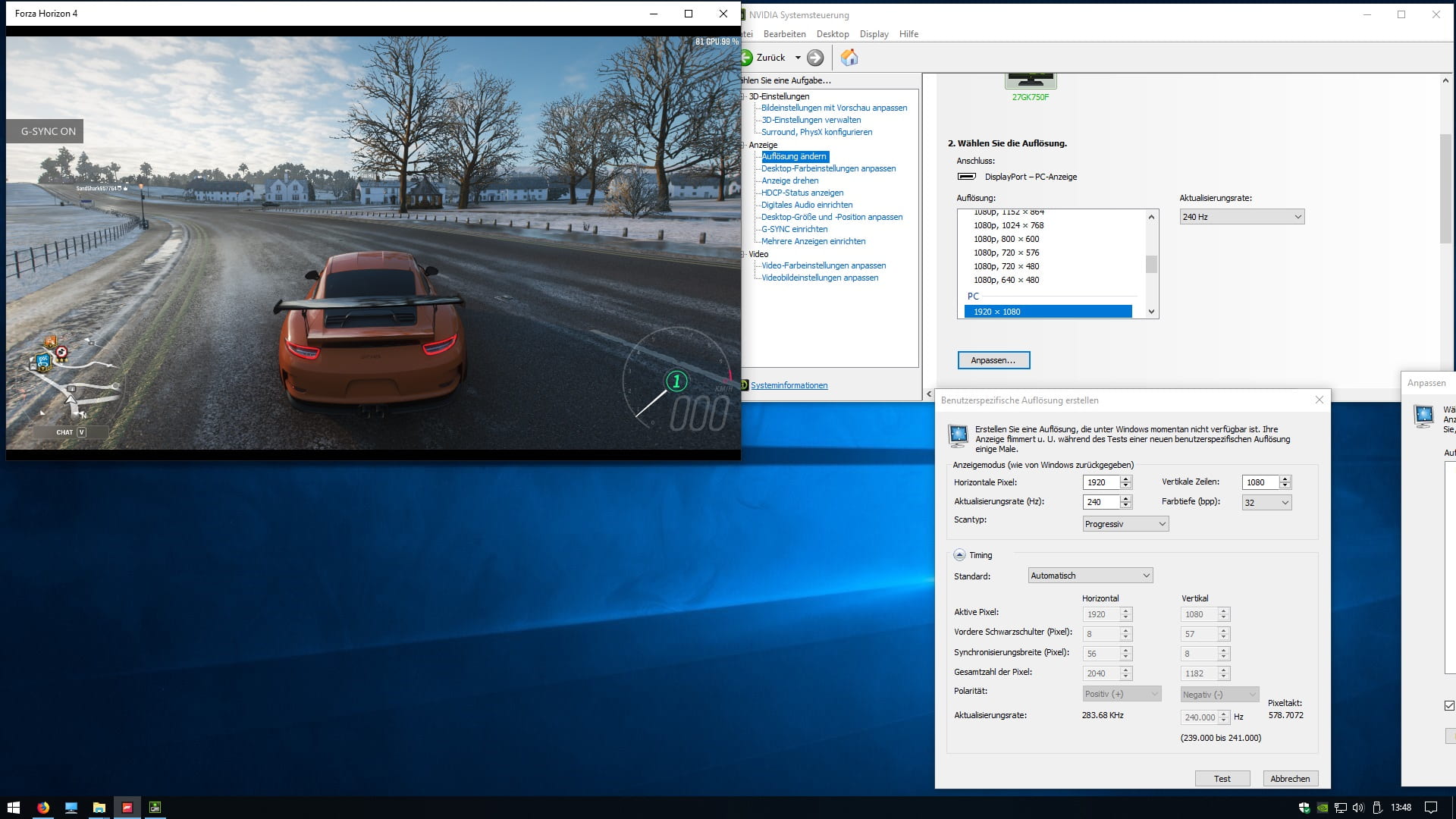

Follow up: I have managed to get it working by reverting to stock "default" 239.759 settings via CRU restart.exe, then enabling g-sync there, leaving on while working and then going back into CRU to edit to the custom VT. I have not tested it in games but it works using the nvidia pendulum test. Now all i have to do is test g-sync in game, as well as test the custom VT usability to see if the frameskipping issue is solved, but so far so good.
