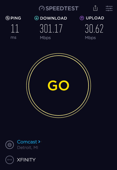

Im posting from my cell phone right now. I played with everything low for a little bit, and at a 1000ms polling rate, my graph doesnt look as flat as yours. Even capped at 120fps. I still had lots of variance and 25ms spikes. Im thinking there might be a network adapter issue related (begause Im not at my current house right now, but Ive noticed playing games like Rocket League after disabling ethernet and wi fi adapters makes the free training mode less stuttery). Sometimes when Im on discord and playinh the witcher, I feel like its less smooth than without having discord. I still have frame time spikes in the witcher, but I will test at my house again. Im thinking is a problem of the motherboard or the adapters because its the same in different houses.

If you're using the included/builtin WiFi and network adaptors, it's quite worth mentioning that the quality of the hardware built into motherboards, defect-free specimens, and drivers/bugs associated with them -- vary quite a lot. And that's why playing the motherboard lottery sometimes gives quite dramatic LatencyMon changes. It's a HUGE hassle, but it's an additional datapoint since most people use the built-in adaptors of the motherboard. If that's what you are using, then full circle back to our "Motherboard Lottery" advice.
At some point, sometimes it's a lot less hairpulling to just grit teeth, pony up the gold, and swap motherboards -- than to lose sanity on diminishing returns of lots of manual tweaking/troubleshoot. It hit so many birds with one roll of a stone dice with better odds.
P.S. Ever upgraded your Internet router to a gaming-optimized one? A gigabit-friendly online-gaming-era modern router usually has lots of performance headroom to noticeably reduce network stutters in many games, though it shouldn't even be affecting your solo gameplay. Most cheap/older "included-with-ISP" routers are often crap and should just WiFi-disabled and bridge-moded/daisychained into a proper well-selected self-purchased router.
And your friend houses probably don't have gigabit-Internet-capable gaming-optimized routers -- 90% just use those routers included with their ISP. And while a few beautiful specimens exist, many ISP routers are just commodity shovelhardware. Heck, some of those sitting at friends still only have 100-megabit Ethernet ports and a piddly processor barely able to route even that fast. Some modern routers are performance overkill, but pushing only 25Mbps through a gigabit-Internet-capable router, makes the same 25Mbps feel better than through a cheap older router, thanks to all that extra performance headroom to process all those packets with minimal router-induced jitter. It's actually a noticeable difference, some cheap routers add a lot of jitter as they struggle to thread all its internal filtering/routing/etc overheads in a modern IoT household full of Androids/iPhones/iPads/Netflix/smartTVs/etc (even when they're just idling, they're pinging and polling all the time and adding noise to the WiFi airwaves that slow down the PC WiFi -- or even the PC Ethernet -- as those old WiFi router processors were often single-core and had to multitask routing the Ethernet/WiFi. Sole WiFi device and no neighbours using WiFi, you're often fast. But 10 or 50 WiFi devices (even 9 of them idling and merely pinging for updates/new messages) plus your neighbours, now your WiFi is clogged and all that struggling within an old crusty router actually sometimes bleed to Ethernet port underperformance. Overloaded to the point where a surge of a few tiny email/Messenger packets actually build up to a noticeable human-visible network-induced stutter for the game connection. In those crappiest, oldest routers that use the same single-core processor for everything (WiFI+Ethernet). Yuck. You can't imagine how many >10-year-old routers are still in use today!
(FWIW, I have gigabit Internet now, but for years I was on various Internet connections 6Mbps through 50Mbps -- and a really good router does make a noticeable difference too when working with a good motherboard with good networking).
Certainly networking is part of the stutter puzzle, but it does not excuse a crappy motherboard or networking. A good router must be talking to good networking (in motherboard or add-on adaptor) to truly sing nice numbers.
And even if networking is fixed, you might not fix everything related to the motherboard. There are so many weak links lurking in some motherboards (even of top-quality brands) that the motherboard lottery can still be worthwhile above-and-beyond fixing networking.

Martinengo wrote:Im thinking there might be a network adapter issue related (begause Im not at my current house right now, but Ive noticed playing games like Rocket League after disabling ethernet and wi fi adapters makes the free training mode less stuttery)
Hm, good to hear one of my earlier suggestions may be having an effect on this. Networking can obviously have a huge impact on framerate/frametime performance in online games.
For reference, my Netgear Nighthawk C7000 (modem/router combo) is wired directly to my motherboard's ethernet port:
