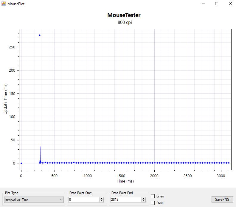

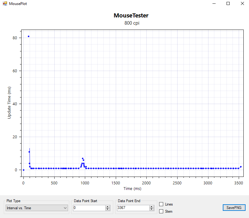

First image is my G pro wireless at 800 dpi 1000hz, second image is a brand new deathadder elite i just got in today also 800 dpi 1000hz. Not sure what happened with the deathadder and the little hiccup it had as more tests showed it performing pretty much identically for that plot the only difference being its a wired mouse, its heavier, granted its more ergonomic, but it also has pretty bad smoothing past 1800 dpi whereas the logitech does not, for some people that matters. I see absolutely no shortfalls with the wireless mouse, maybe someone who has a router a few feet away blasting a 2.4ghz signal at 100% power will have issues, but my router is elsewhere and set to 25% power so i don't get interference.

Malinkadink wrote:First image is my G pro wireless at 800 dpi 1000hz, second image is a brand new deathadder elite i just got in today also 800 dpi 1000hz. Not sure what happened with the deathadder and the little hiccup it had as more tests showed it performing pretty much identically for that plot the only difference being its a wired mouse, its heavier, granted its more ergonomic, but it also has pretty bad smoothing past 1800 dpi whereas the logitech does not, for some people that matters. I see absolutely no shortfalls with the wireless mouse, maybe someone who has a router a few feet away blasting a 2.4ghz signal at 100% power will have issues, but my router is elsewhere and set to 25% power so i don't get interference.
Is not interference bud, and those graphs are not the right way to show it. You need to zoom in. If you notice on the Logitech mice your first value is 50 and on DA is 20... you can´t compare graphs like that and you will defo need to zoom in to 1 - 1,5 interval.
Me and the players that do not like wireless and had inconsistent polling rate with it, do not suffer from interferences. I don´t even have an wireless router on there, I have ethernet cables inside my walls and my phone is always with the wireless OFF. My PC has no bluetooth or wireless, so is not interference. is simply a limitation on the technology, wich is normal, it is wireless afterall, impossible to be exactly like wired.
And this is more noticeable on 240hz btw and high framerates like cdcd said. If you play 100fps or 144hz you won´t notice it. I notice it on windows desktop immediatly when I try wireless mice, is like it skips a pixel every X ms.
