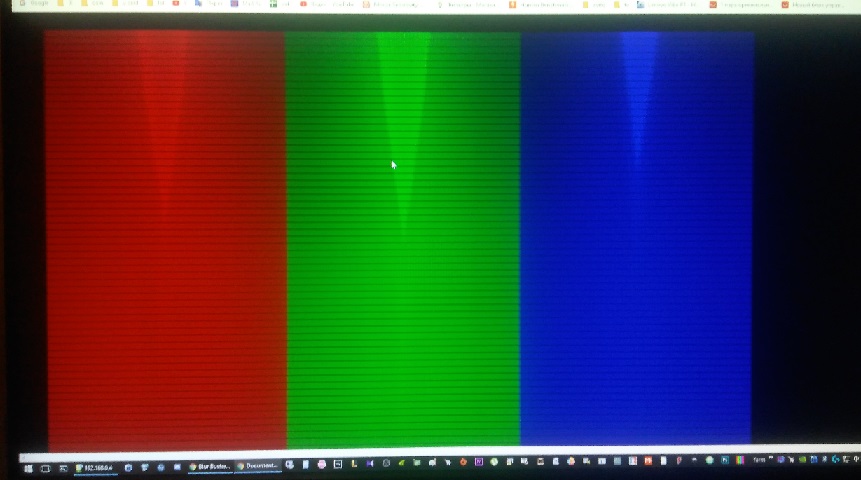

I slightly modified the test.
fast
https://1kwatt.github.io/fast/
slow scale
https://1kwatt.github.io/scale/
This is what my xn253qx looks like (slow scale). With stock settings.
Why I want to connect this particular problem with problems from other topics on the forum.
For example, for green.
at a frequency of 240, artifacts are visible on green color 225, 226.
at a frequency of 200, artifacts are visible on green color 232, 233, 234, 235, 236, 237.
at a frequency of 144, artifacts are visible on green color 240, 241.
at a frequency of 120, artifacts are visible on green color 246, 247,248.
When reducing the hz of the monitor or when using vrr with low fps. Artifacts move closer to r255g255b255.
And they become more noticeable at the peak transition colors in games.
For me, the picture on the stock settings at 144hz is just awful. :(
This is not a first generation panel.
Perhaps once again I was not lucky, a lottery with a panel.
And maybe my test has nothing to do with those problems.
