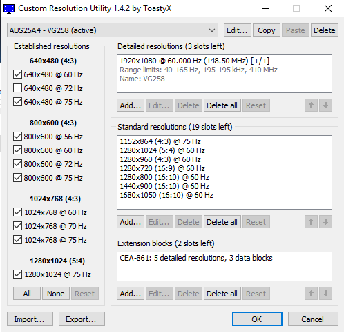

Yoo dude! Thank you for your reply i really appreciate it!
So i downloaded CRU but i dont know what to do now.. Could you help me please?
I also attached a screenshot of the CRU window that i have.
- Untitled.png (23.86 KiB) Viewed 7592 times
																			 karavanasam
- Posts: 185
- Joined: 16 Mar 2019, 14:41
						Post
								by karavanasam » 19 Nov 2019, 10:27
			synki123 wrote:karavanasam wrote:synki123 wrote:I double checked that my monitor actually runs @165Hz.
I tried setting trace from 100-0 and that didn't help.
Tried turning On ELMB but it makes the ghosting much worse.
Tried using the best OSD settings for this monitor, still didn't help.
I am using a display port 1.4 and i also double checked that it's plugged well into the monitor and gpu, i also tried plugging the cable onto other displayport ports.
I am really confused right now because people in this forum who own this monitor like me, report that they don't see any ghosting at all...
My specs are: gtx 960 gpu and a ryzen 7 1700x cpu
Hopefully you can try help me out of this situation because right now i think i'm the only person who gets ghosting with this monitor.
I will more than appreciate your help!  Thanks in advance!
Hey there friend.I came here to help!
There are 2 methods for this.You cant use adaptive sync with gtx 900 series.So you need to buy a newer Nvidia Gpu 1000 or 2000 series or AMD Gpu to use adaptive sync and lower your ghosting.
Or you can do just like me.I have 980gtx and I also cant use adaptive sync.I dont want to buy a new GPU.So I made a little adjustment.I used CRU to change monitor's timing.I change timings of 165hz from lcd standart to lcd reduced.Try this method and you will see less ghosting.If you need more help about changing timings,write again and I will do my best.
Yes of course.Happy to help.I hope result makes you satisfied.
So you see Extension blocks.Double click that.New screen comes.Double click 1920x1080 165 hz from detailed resolutions.New screen comes.You see Timing.Enter that and select Automatic Lcd Reduced.Then press ok.Another ok.And then another ok.Next step will be to reset or shutdown your PC.Then turn your PC on with new timings and test in games.
																			 synki123
- Posts: 6
- Joined: 17 Nov 2019, 10:17
						Post
								by synki123 » 20 Nov 2019, 06:20
			karavanasam wrote:synki123 wrote:karavanasam wrote:synki123 wrote:I double checked that my monitor actually runs @165Hz.
Okay i did everything u said bro, the only problem now is that it's hard to tell if it's better or not..
