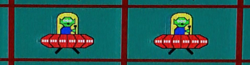

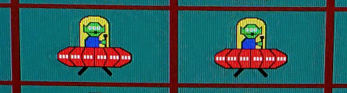

Ansive wrote: ↑
27 Feb 2020, 22:57
I got the monitor today.
Is this the expected amount of crosstalk I should expect at 100hz and 120hz using purexp?
(I used 1/125 exposure to get the pictures, they look very similar to what I'm seeing)
Yes, looks correct.
It looks like you photographed only bottom 2/3rds of your screen -- including center and near bottom edge of the screen -- so I'm focussing closer to the top edge of your photographs because that represents your screen centre.
Yes, this is within the expected crosstalk-visibility range for most 1ms panels (IPS and TN) for the amplified-visibility TestUFO Crosstalk Test. It is normal for bottom edge to look worse than screen centre.
Overall, this is much better than any other IPS strobing and VA strobing as you can see in RTINGS / TFTCentral images, and there are some TN panels with worse crosstalk than this. When you switch to www.testufo.com/photo it becomes much less visible.
Also make sure your monitor is not cold (warm up for at least 30-60 minutes first if in a freezing room in the winter) to avoid temperature-related increases to crosstalk -- cold rooms can increase strobe crosstalk by a tiny bit on many LCDs. That said, what I am seeing is already within the range of what I see.
Zoom the TestUFO test via the [Full Screen] button in the TestUFO test, and you'll see crosstalk is lower in the screen centre, than for screen top/bottom. This is normal as the near-crosstalk-free priority is screen centre. It is normal to have slightly more crosstalk at the top/bottom screen edges with global-strobe backlight displays of all technologies. Now if you switch motion tests to www.testufo.com/photo or game imagery such as www.testufo.com/framerates-versus -- it becomes harder to see the crosstalk.
I've cropped a reference of the lower-crosstalk portion of your photographs (portion of screen corresponding to regions closer to the vertical center of screen).
XG270 IPS strobe, 100 Hz, close to screen centre
XG270 IPS strobe, 120 Hz, close to screen centre
This is what it looks like on my unit, too.
Comparing to my reference XG270, these are quite similar -- I've seen much worse than this on most IPS and VA panels and quite in the middle of TN territory (much better than the worst TN). If you compare these to RTINGS and TFTCentral strobed pursuit images, you'll see your screen-centre PureXP+ crosstalk is lower than most of them at the same refresh rates (And probably darn nearly all of IPS and VA prior to 2020!!).
Obviously, the TestUFO Crosstalk is specifically designed to amplify strobe crosstalk visibility. So crosstalk in this specific test looks more noticeable than video games and even browser scrolling (smoothscroll by keyboard or mousewheel). So crosstalk in majority of real-world usage should be less noticeable than in this specific test.
Note: Stationary photographs (non-pursuit) are acceptable for crosstalk analysis purposes as only one stationary strobe flash needs to be recorded, to determine if the LCD has sufficiently refreshed for that particular single strobe backlight flash.
