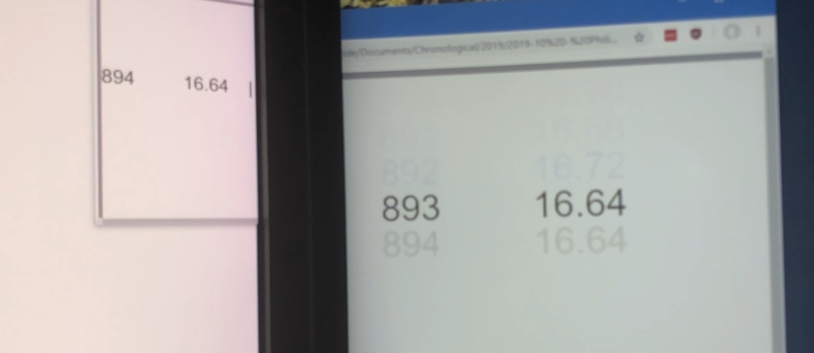

I can verify that the Philips BDM4065 is lagging when compared to my other monitors by running this web-page I created in a browser that straddles two monitors (left side on one, right side on the other) and recording the screen with my iPhone's slo-mo (240fps) camera mode - here's an example showing the lag (the HP Z27q 5K is on the left, and the Philips 4K is on the right):

Bizarrely, I booted my computer up just now and the lag's gone again. And my input-lag comparison web-page now shows my primary monitor actually being more responsive than my 5K monitors (I really need an absolute measure of lag though):
