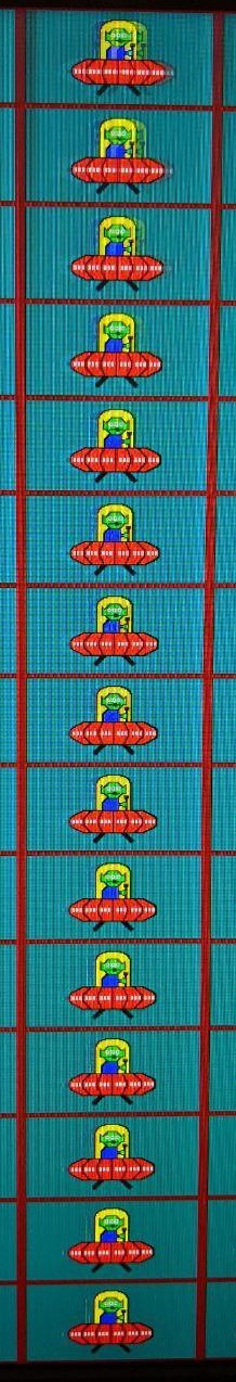

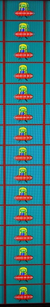

Post by GammaLyrae » 02 Jun 2020, 21:00
Regrettably, I only have my phone camera to work with and the non-modifiable shutter speed strongly disagrees with the strobing screen and fast moving objects. I cropped the images to include a complete vertical slice of the screen top to bottom.
"119hz" looks slightly softer, but has no inversions. Crosstalk is a little more present overall, but I personally find it less distracting than inversion artifacts. The after images seem a little dimmer than the inverted trails of 120hz.

"120hz" looks the sharpest, but the after images are inversions which are a little more distracting. The after images also appear brighter to my eyes in person. The topmost box I find most interesting, since there are 3 total aliens visible - two normal colored ones overlapping, with a third inverted one trailing behind. In the "119hz" image, only two aliens appear visible and neither are inverted.
120hz inversion.jpg (137.86 KiB) Viewed 9799 times
When viewing either of these refresh rates on https://www.testufo.com/refreshrate , they both report as exactly 120hz with no decimal values, but they have very different performances. I'm not sure which one is the intended tuning for 120hz, but I personally find the "119hz" mode less visually distracting in a torture test like the ufo crosstalk, and real world use like browsing blogs, forums, and playing games. "119hz" has the most in common with the kind of crosstalk I've seen in 100hz, "119hz", and 240hz.
You meant coronas (inverted-color images) rather than inversion artifacts (LCD voltage inversion)
Yes, this is tough tradeoff -- the more I try to reduce the ghost, the more corona appears. And vice-versa. That's because the GtG is bigger than the VBI, and enroaches the top of the scanout. As not all pixels refresh at the same time, as seen in high speed videos, www.blurbusters.com/scanoiut
To try to fix the top-edge crosstalk, caused the remainder of the screen surface to become worse (i.e. a worse corona/ghost appeared ion screen centre). We had to land on a specific goldilocks number that more users were happiest with. Decisions involving laws of physics are extremely tough. So we compromised on an ultra-faint ghost combined with an ultra-faint corona at the top edge, to save the rest of the screen surface (keep rest of screen corona-free). Metaphorically, basically allowing a faint corona at top edge, to keep the rest of the screen surface corona-free / ghosting-free.
We found most users preferred screen center to be sharpest, even if top edge was ever so faintly worse. That said, if you prefer ghosting-biased tuning (increase ghosting to decrease coronas), certianly continue to use 119Hz. (Ideally, I wanted OD Gain to be a DDC command as I advocate more overdrive flexibility exposed to end users, but most manufacturesr prefer not to expose such advanced adjustability). That said, I realize many people have different sensitivities to ghosting/corona artifacts.
I actually did some test right now after seeing your posts, and can confirm I have basically similair results to yours. The 100hz with PureXP+ on Extreme\Ultra indeed looks like the best quality glass smooth on ghosting tests.
Now I can't really decide which one is better the 119hz or the 120hz default ones in NVCP. Seems like 119hz is tiny bit more smooth, 120hz indeed feels like a tiny little bit worse but bit more sharp, with some trailing in the middle section and 3 ufo's at the top just like you said. Still need to test the custom 120 hz mode in CRU that was posted in this forums.
