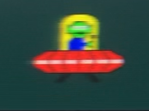

Sorry, but your pictures of the Alienware AW2521HF do not correspond to reality. They look a lot better in my tests. Look at the pictures:RLCScontender wrote: ↑13 Jun 2020, 15:35EXTREME OD is 3.4-3.5ms g2g. The unique DP scaler on the alienware monitor chooses the best OD setting(variable overdrive) which minimizes ghosting and overshoot, and it decided to choose 3.5ms g2g. Which is probably the optimal setting withuot any overshoot. Whereas the MSI MAG251rx has 5-6% overshoot but a much faster response time at 3ms g2g. I will EASILY pick a faster response time with playable overshoot than a slower response time with no overshoot.

- AW2521HF gsync-on extreme_single_brighter.png (75.88 KiB) Viewed 13318 times
- AW2521HF gsync-on extreme_single.png (71.63 KiB) Viewed 13318 times

Re: AW2521HF vs. MAG251RX
Umm i measured the actual response times with an oscilloscope
Also just by looking at the dome, there is def. Ghosting. In the msi there is no ghosting on the dome, just coronas
Here are the perfect straight line ufo tests if u arent convinced
Left msi right alienware
