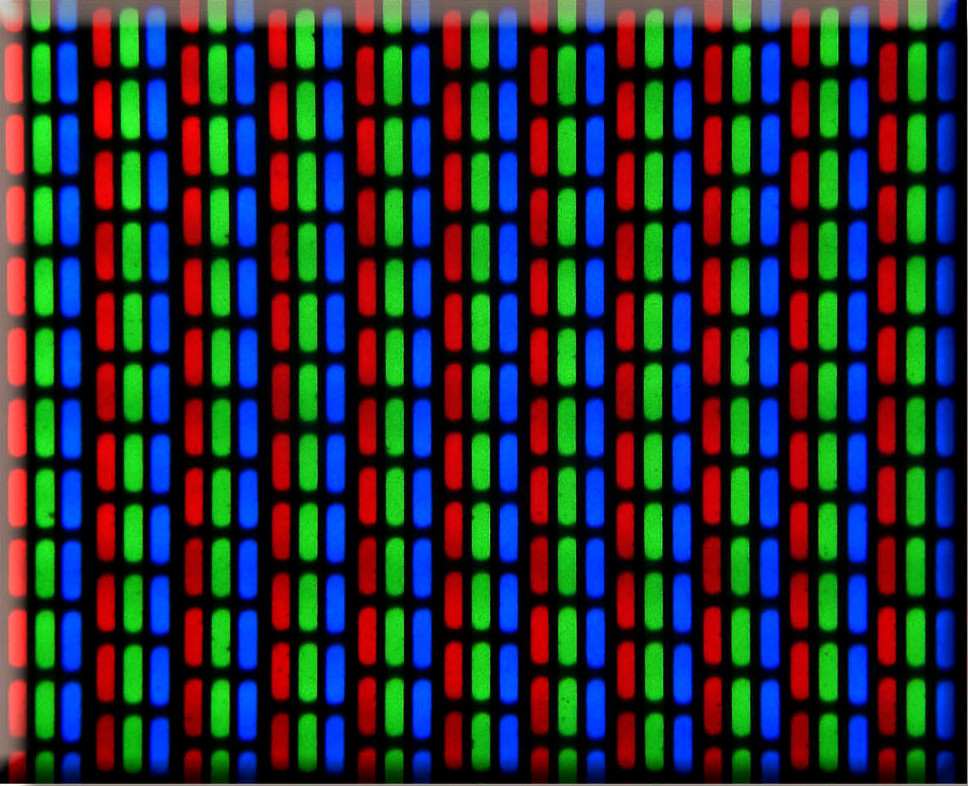

I don't know exactly how CRT Shaders work but as I understand it they use several pixels to render what would be one individual phosphor on a CRT. If you do a screengrab of an arcade game in MAME at 4k the screengrab itself will be in 4K and the shaders themselves rely on high resolutions(particularly slot mask shaders which need extremely high resolutions like at least 8K to emulate properly)

That said, stroboscopic scrolling effects of dotmask/grille does require low MPRT to be visible, though this is not generally visible to most people at normal CRT viewing distances, and even when becomes visible, is extremely subtle as you've already noticed.

Personally, I prefer 4K + CRT filters for original faithfulness, some settings can look reasonably good with that, even if not perfect.
One has to define "scaling". Applying forms of CRT filters is a glorified scaling algorithm.
