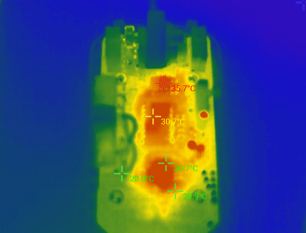

Windows kernel timer has a limit of 0.5 ms interrupt intervals. the source of time itself within os. why do you believe you can plug anything of 8000hz or more in 99.99999% of systems and expect no perf degradation? and think it will work properly.
pixart sensors per their specsheets have a temperature operating temp of 40deg c, thats junction inside not on top where its cooler. heres a pic of xm1 on 1000hz from being moved with OPEN shell for 5min. scale up for closed shell usage and being used with a sweating palm and ofc working sensor in a fps game. just moving it causes spikes of mcu sensor to go up to 36-40 deg C

40 Celsius is very cool operating temperature for electronics. I believe the reason Pixart specs their sensors to those temperatures is because that is what they currently tend to run at so they design around it. If higher hz sensors started producing more heat and even if better cooling was inadequate then Pixart and others can design around the new higher operating temperatures.

I also did not notice any heat difference between the 1000Hz mouse and 8000Hz mouse; the sensor readrate on the 1000Hz mice is approximately 12-16KHz already, and the sensor readrate on the 8000Hz mouse is 20KHz and actually seems slightly cooler, probably due to improved electronics. I wouldn't worry about the mouse-heat aspect.
But yes, peformance can degrade on some systems because not all systems can handle a 8KHz poll rate.
It is my understanding that 8khz mice already work in Windows, either via hacked driver or the new gen that is in the works. The 0.5ms Windows timer is not a hard cap of 2khz on hardware.
40 celsius is nowhere near very cool for electronics. temperature scaling is exponentional with frequency of those electronic devices you think about. just because something works doesnt mean its working at optimal performance, and it needs to work with optimal performance 8000 times a second.
Pixar doesnt even give you full documentation of the registers/firmware impl if you are their customer, so no, their specs are adjusted for marketing just like all others are ( TiN from evga who designed top extreme OC mobos warns about spec sheets being marketing material here https://xdevs.com/article/tcr_test/ )
waiting for Razer The_Fiend to provide some measures(under load with full system specs).
