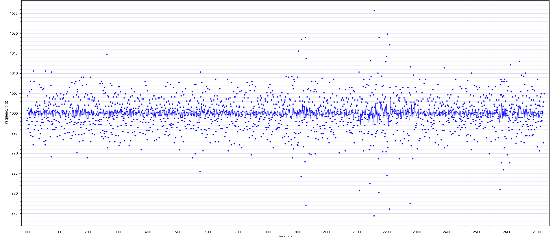

Below are 3yr old FC5 benchmarks with my older configuration. HPET/useplatformclock was literally the only change between the 2 runs.
HPET/useplatformclock OFF:
HPET/useplatformclock ON:

Those 3yr old benchmarks were on my 8700k + 1080 Ti.
Not only did I see reduced performance across all games, I also noticed erratic mouse cursor movement and even Windows GUI performance degradation.
So in my case, it was 100% not just some "benchmark timing calculation inaccuracy due to clock timer reference".
Don't confuse clock resolution with the cost of using a certain clock source.
Also, on some systems like mine (Asus Hero X), you cannot disable HPET in the BIOS. Unless I'm missing something, disabling HPET in dev mgr, deleting useplatformclock, enabling useplatformtick should achieve the same/similar results.
FYI, I also enable disabledynamictick .
I watched Fr33thy's HPET video and he's basically saying same thing. Disable HPET/useplatformclock in OS.
Also, to clarify, HPET incurs more overhead compared to TSC. That is the main reason for reduced performance...
Keep in mind that you want to disable all CPU power-saving features in BIOS to also eliminate any effects on latency and the TSC timer.
