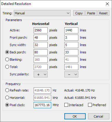

The new DisplayID embedded as a CEA-861 Extension Block in EDID, supports 1000 Hz refresh rates just fine.
The latest verison of ToastyX CRU can create >500Hz via CRU -> Extension Blocks -> Switch from "CEA-861" to "DisplayID" -> Add -> Detailed Resolutions -> Add Blocks -> Add -> DisplayID -> Edit the DisplayID (looks like a regular custom resolution editor, but accepts quadruple-digit refresh rates).
The current DisplayID limit is about 6752.19 Hz, which is enough for a few decades of retina-ing out the refresh rate race, even though 6752 Hz is below retina refresh rates in certain situations (180-degree FOV retina-resolution VR, wold actually show human-visible limitations of 6752 Hz...)

Chief Blur Buster wrote:
02 Nov 2020, 14:05
DisplayID 1.3 supports a pixel clock up to 167772.16 MHz, and DisplayID 2.0 supports up to 16777.216 MHz. CRU 1.4.2 wouldn't allow more than 10000 Hz/kHz to prevent overflow issues with calculations, but I've worked that out in CRU 1.5.
The VESA CVT formulas also completely break down at higher refresh rates because the minimum required blanking time exceeds the total refresh time, so they're going to need a new standard for extremely high refresh rates.

ToastyX wrote:
01 Jan 2021, 18:56
Great to hear! Thanks for doing this...
No utility formerly let me create refresh rates higher than 6752, so I am very glad to be mistaken.
Still disappointed that the dot-clock limit is lower in DisplayID 2.0 (16.7 GHz) than in 1.3 (167 GHz) because that prevents single-cable 8K 1000Hz which requires a minumum of slightly above 33GHz dotclock at minimum possible blanking intervals. That said, no cable supports 167 GHz 24bit pixel clocks anyway, so this is moot for now.
There is even an engineering path to 8K 1000Hz inside of this decade! Hopefully a future version of DisplayID resolves this.
ToastyX wrote:
01 Jan 2021, 18:56
Yes, so Manual is going to be required for now.
