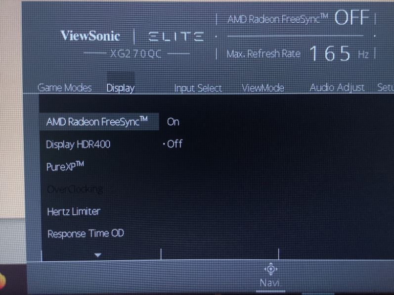

No, it is not, currently only the XG270 (no suffix) is the Blur Busters Approved one. The XG270QC and XG270QG has the slow red phosphor which creates ghosting during PureXP.
The JD.com link you gave me for XG270QC, is not authorized to have Blur Busters Approved mention, can you tell me where on the web page (screenshot) it says Blur Busters Approved?
However, XG270QC does indeed have PureXP. But you have to turn off FreeSync and make sure refresh rate is 75Hz or higher, in order to activate PureXP. It just will have a slight amount of red phosphor ghosting. Some people find it okay, others don't like it. Give it a try before deciding to return it.
I did personally tune XG270QC myself for ViewSonic, so it does have PureXP built into it. If PureXP is missing then please take a photo of the Display Menu and inform me. Perhaps PureXP is spelled differently in Chinese, but PureXP will be the item that is 2 rows below the FreeSync line.
You have to turn off "AMD Radeon FreeSync" first before enabling PureXP
Otherwise, PureXP is grayed-out. Please turn off "AMD Radeon FreeSync" to be able to enable "PureXP":

Oh, that's the XG270QG, the JD.com link shows both models.
There are multiple XG270s:
XG270 - 1080p 240Hz FreeSync (G-SYNC Compatible) with PureXP+
XG270QC - 1440p 165Hz FreeSync (G-SYNC Compatible) with PureXP+
XG270QG - 1440p 165Hz G-SYNC with ULMB
Your model has ULMB, not PureXP+. Neither model is licensed to use the Blur Busters Approved Logo that was awarded to the XG270, so JD.com was the one in error. The JD site still has incorrect information since the XG270QG does not use the PureXP+ branding, but the ULMB branding.
