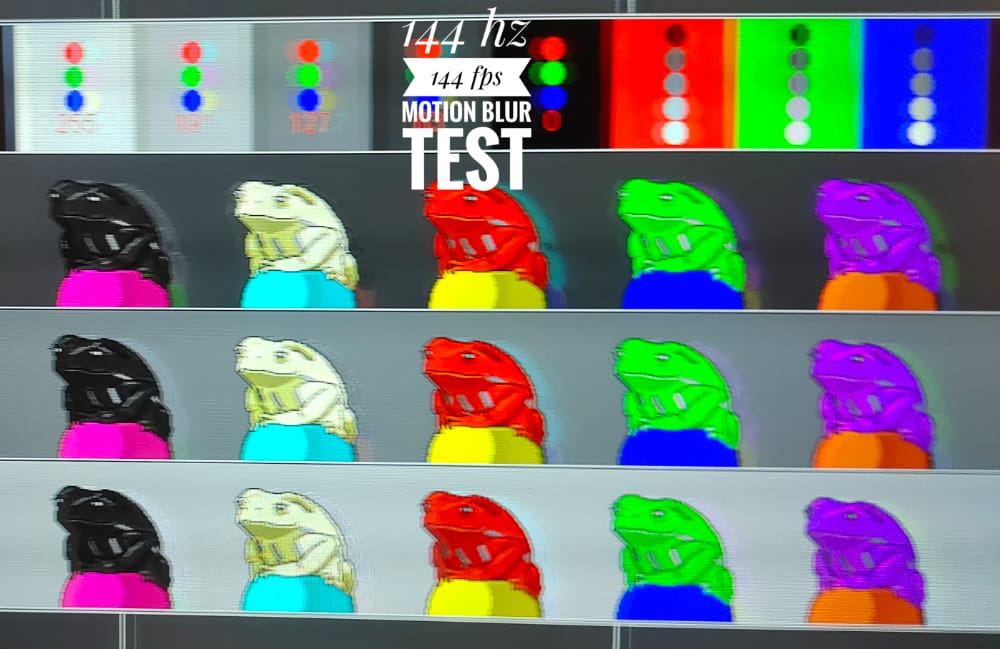

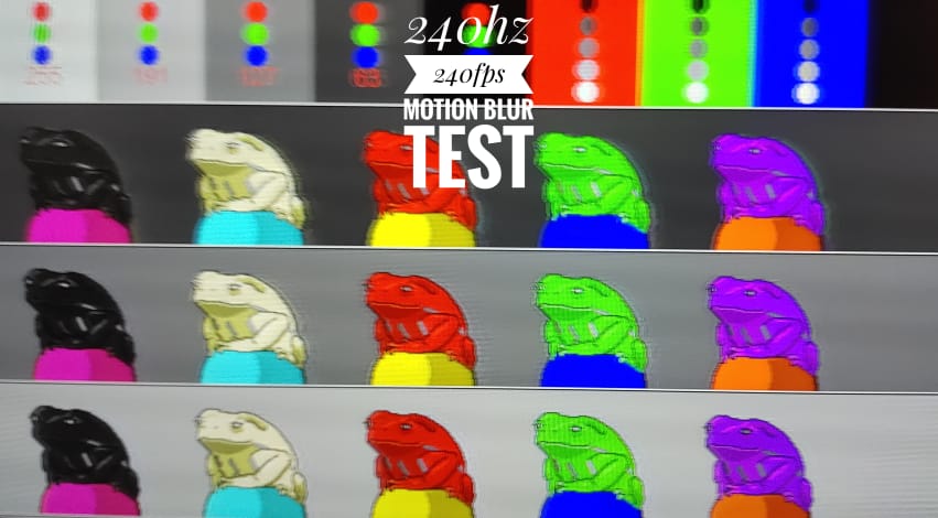

Hey guys, I found the solution in the vg259qm to make ELMB SYNC work perfectly and get a clear, tear-free image. The situation is the following.
I have not found anyone else in any forum not even on Blur busters who talks about this.
This only applies to Asus monitors with ELMB SYNC.
Using the UFO Ghosting test, when only ELMB is activated without adaptive sync, the image with normal reduced motion blur is produced without further ado.
When ELMB and adaptive synchronization are activated simultaneously, it is observed how a bit of crosstalk strobe is created in the UFO, making the image a bit worse, but it is still much better than not using ELMB.
What is the problem with the UFO test?
The problem is that it runs in a search engine and the search engine does not recognize adaptive synchronization, that is why I have used the tool provided by the page
Made by the a5hun Youtube channel called Frog Pursuit. This tool works to see the ghosting of the image as well as the UFO test with the difference that this tool can be executed in full screen and in unrealengine 4, being able to support adaptive synchronization.you can find this tool in aperturegrille . Com
For what I will say next, the previously mentioned tool was used.
The following applies only if you use ELMB and adaptive sync at the same time:
If you are using 240-280hz on the Nvidia panel the following happens. As your fps in games decreases from the monitor's Hz value, the reduction of motion blur will also decrease and it will be more like having it off.
This is the reason why many reviews say that ELMB SYNC works only between 200-280 fps because when it decreases from that it "is better" to have it turned off.
Example if you use 144 fps or less, the motion blur reduction will be practically zero.
I have found the solution to this problem with frequencies below 200 hz.
Before this monitor I have had a 144 Hz 27 inch Acer that also had a backlight strobing technology called "MPRT" with levels: off, on and extreme.
This technology works with any refresh rate, be it those predefined by the monitor itself or a custom frequency, example: 140hz.
Unfortunately Unlike MPRT, ELMB without sync only works with the frequencies predefined by the monitor: 280,240,144,120. It cannot be used with custom frequencies.
Having said this explanation, how do you solve the ELMB problem with adaptive synchronization below 200 hz?
Unfortunately, manually:
You have to find an average fps in the game that you can maintain most of the time and adjust from the Nvidia panel the frequency that is similar but that is obviously above your fps.
Example: you have an average of 150-130 fps so you place the monitor on the Nvidia panel at 144hz and lower the fps to 140 so that it does not exceed the frequency of the monitor and adaptive synchronization is not deactivated. Always set 4 fps less than your refresh rate.
Because the fps limiters in games are not accurate and sometimes go higher than the maximum fps selected. Unless you are using an external limiter like RTSS (Riva Tuner Statistics)
And you do the same if you have between 100-120 fps you put 120 hz on the monitor, etc.
What I conclude is that adaptive sync if adjusted to monitor fps, while ELMB still uses the same 240hz setting and does not adjust to fps, progressively creating motion blur while decreasing fps.
Now, if you agree, ELMB only works with the predefined frequencies: 280,240,144,120 and NOT with custom frequencies.
This is where my question for bijam comes from and I don't know if you could help me to contact Asus or clarify me in case this has no firmware solution:
In Apex I normally play at 180 fps and this is a problem because as I already explained ELMB SYNC (I clarify: when I say SYNC and not only ELMB I mean that it is activated simultaneously with G-sync)
when the fps is close to the frequency that it is in the Nvidia control panel, and I can only choose preset frequencies
(280,240,144,120), is it possible via firmware to request Asus to add more intermediate frequencies?
For example 165, 180, 200, etc. Because I'm not sure if they could be tuned by ELMB firmware to allow any custom frequency to be used.
If anyone. Could help me with this will be so cool.

a5hun in his video did not explain that using ELMB SYNC, NOT JUST ELMB, for fps less than 200 you have to manually lower the frequency to adjust to your average fps, because in the tests that he performed and are on his page, it shows that a As the fps drop the image loses clarity and that's because he didn't adjust the monitor's Hz while lowering the fps.axaro1 wrote: ↑31 Dec 2020, 04:46This issue is exactly the one described by a5hun in his VG279QM video, enabling ELMB + Adaptive Sync forces double pulse strobe which does not benefit motion clarity.
with ELMB + Adaptive Sync to check it yourself, you'll see two lines moving instead of one (I'm not talking about afterimages, I'm talking about the main line).
ELMB + Adaptive sync is unusable for this specific reason, even if you could cap at a refresh rate that you can reach 100% of the time.
Fps fluctuations are another issue with ELMB-SYNC because VT variance at different refresh rates due to Adaptive Sync managing Vertical Totals causes unpredictable Crosstalk Areas.
Standard ELMB is nice on this monitor, especially at 280hz where the overshoot penalty of OD80 is reduced compared to 240hz
Now, when you manually lower the frequency to 144 and continue using ELMB SYNC it creates a lot of overshoot but in practice I personally don't notice it too much, the ufo tests in my experience exaggerate the crosstalk with ELMB SYNC too much as seen in game.
I play Apex Legends and Warzone and when I realized this, especially Warzone that I have 100-120 fps limit to 120 hz and change the OD: 60 for ELMB SYNC and change completely, everything looks clearer and I have no tears and fluid.
