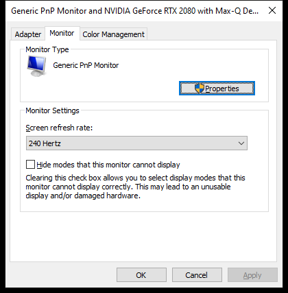

I've been complaining about the difficulty of switching refresh rates for years.
Click Monitor tab at the top.
Screenshot 2021-01-15 21.49.46.png (15.45 KiB) Viewed 8689 times
