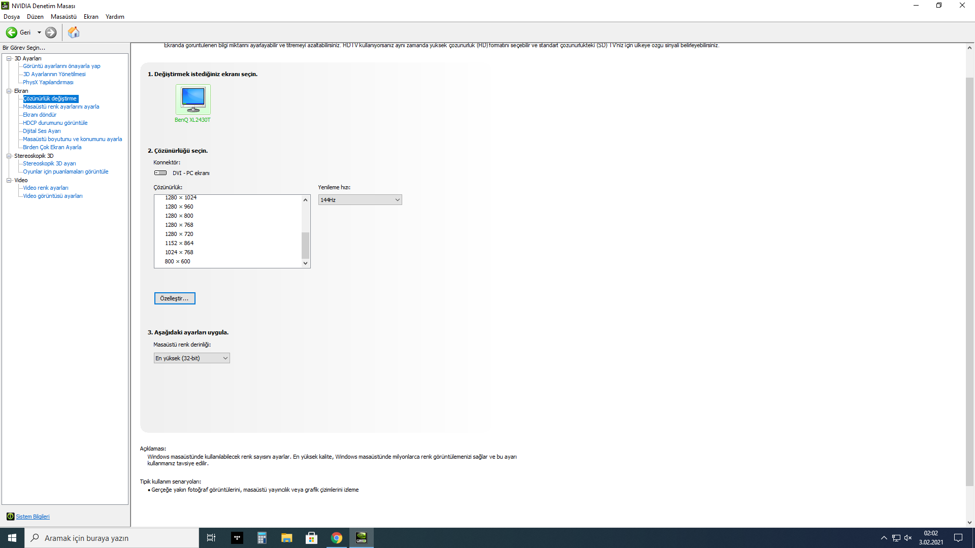

I have the xl2430t model. There is a problem when it passes 165 hz. It does not work above 165 hz. Is it because gtx 550ti old video card?
connected with dvi
The bidet says out of range when I turn it on and off on every monitor, the screen comes up when you press the control button of the monitor, how can I fix it
thanks in advance
pls help
Here is why there is no color depth adjustment video card gtx 550 ti
Ekran Görüntüsü (7).png (125.96 KiB) Viewed 10654 times

I output at 177 hz with 8 bit deep dvi, how can I lower it to 6 bit depth
xl2430
appreciate if you help instant mode and but open
what other settings should i open
