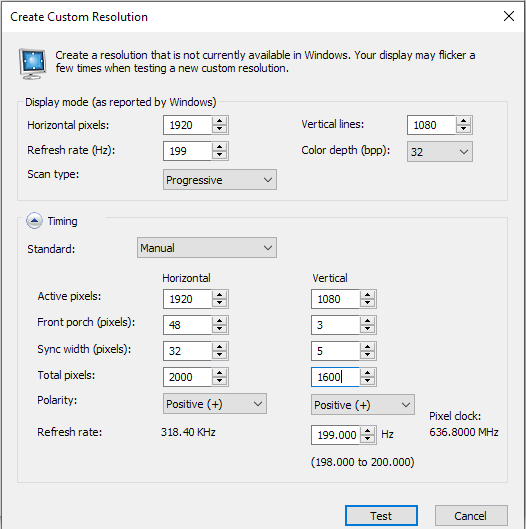

1600 vt
This is my current setting for overwatch
The monitor would say out of range, just click back on s-switch twice the remove the out of range overlay
with 100 brightness, extreme ama and extreme dyac.
when i set to 200hz just black screen but 199 works.
same setting with 180hz have almost 0 crosswalk.

alexander1986
- Posts: 160
- Joined: 10 Jan 2019, 01:07
Re: BenQ Zowie XL2546K 240hz TN
BubbleFishHK wrote: ↑22 Mar 2021, 16:491600 vt
wow nice 1600 vt ! , any chance you could take pic/video of testUFO with this 180 hz / 1600 vt or 199 hz / 1600 vt?
if not maybe you could say in your opinion how is the crosstalk on top / bottom with this settings in the full-screen crosstalk test here:
https://www.testufo.com/crosstalk#photo ... &pursuit=0
if you put that on fullscreen do you see any big crosstalk on top/bottom area ?
because center area already looks almost perfect on this monitor with 240 hz / default VT in my opinion !
