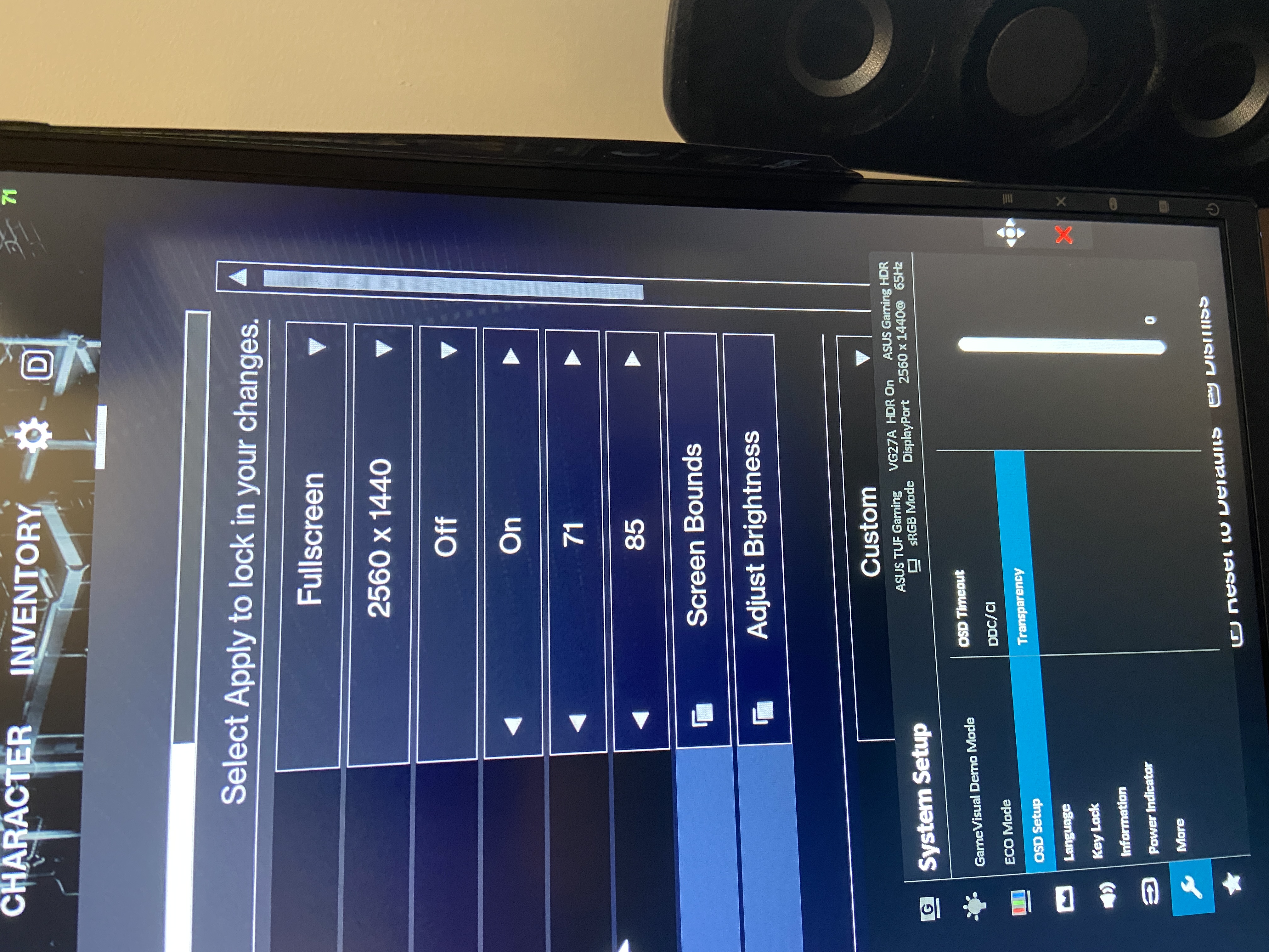

I recently upgrade to the Asus VG27AQ. I did a fair bit of research beforehand, but now that I have it home and have looked even more I got concerned about the low performance of this monitor at lower FPS. I have a GTX 1060 and though one day I would like to upgrade with availability and inflated prices it’s not happening anytime soon. I’m not a huge PC gamer but would like to potentially do more as well as have support for consoles including the ps5 when its actually available. Playing around with the settings a I noticed that in WOW, Destiny 2 and Diablo 3 this monitor seems to report doubling the refresh rate at anything below 70 fps. Change the in game cap to 71 and then the monitor reports 71. I show this in the pictures. This seems to happen on all three games. Googling this there is talk about doubling refreshes at below the VRR range but this it well above the 48hz min of this monitor.
What’s going on here? Does this help with Ghosting? Thank you.
Any recommendations to a similar price point monitor that has better moderate frame rate performance? I haven’t really noticed any ghosting or anything but haven’t really been gaming with it too much yet. Mostly just using it as my “work from home” covid monitor. Thank you.
How bad would a 4k 27” monitor be rendered at 1080p or 1440p upscaled to 4k?

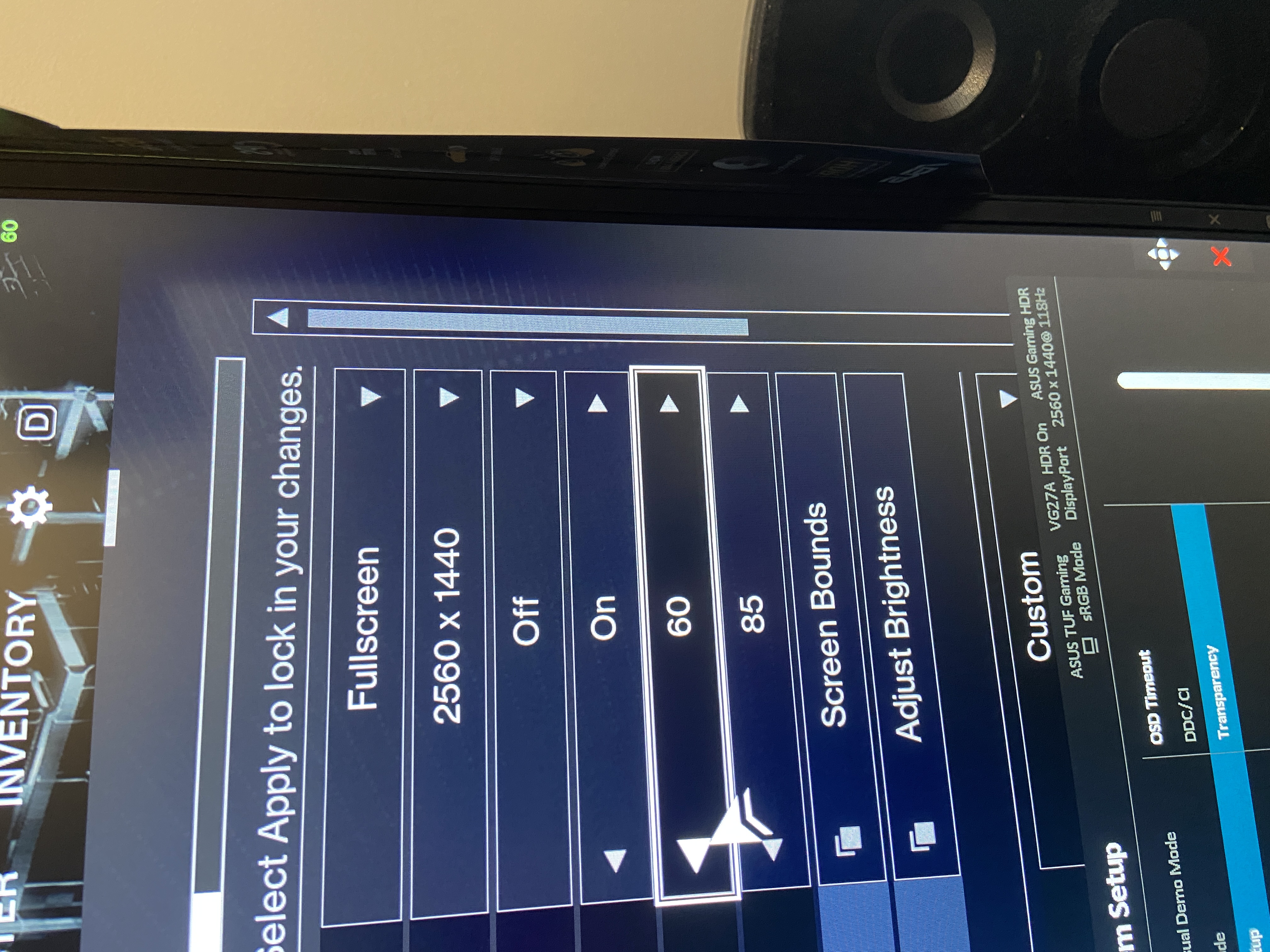

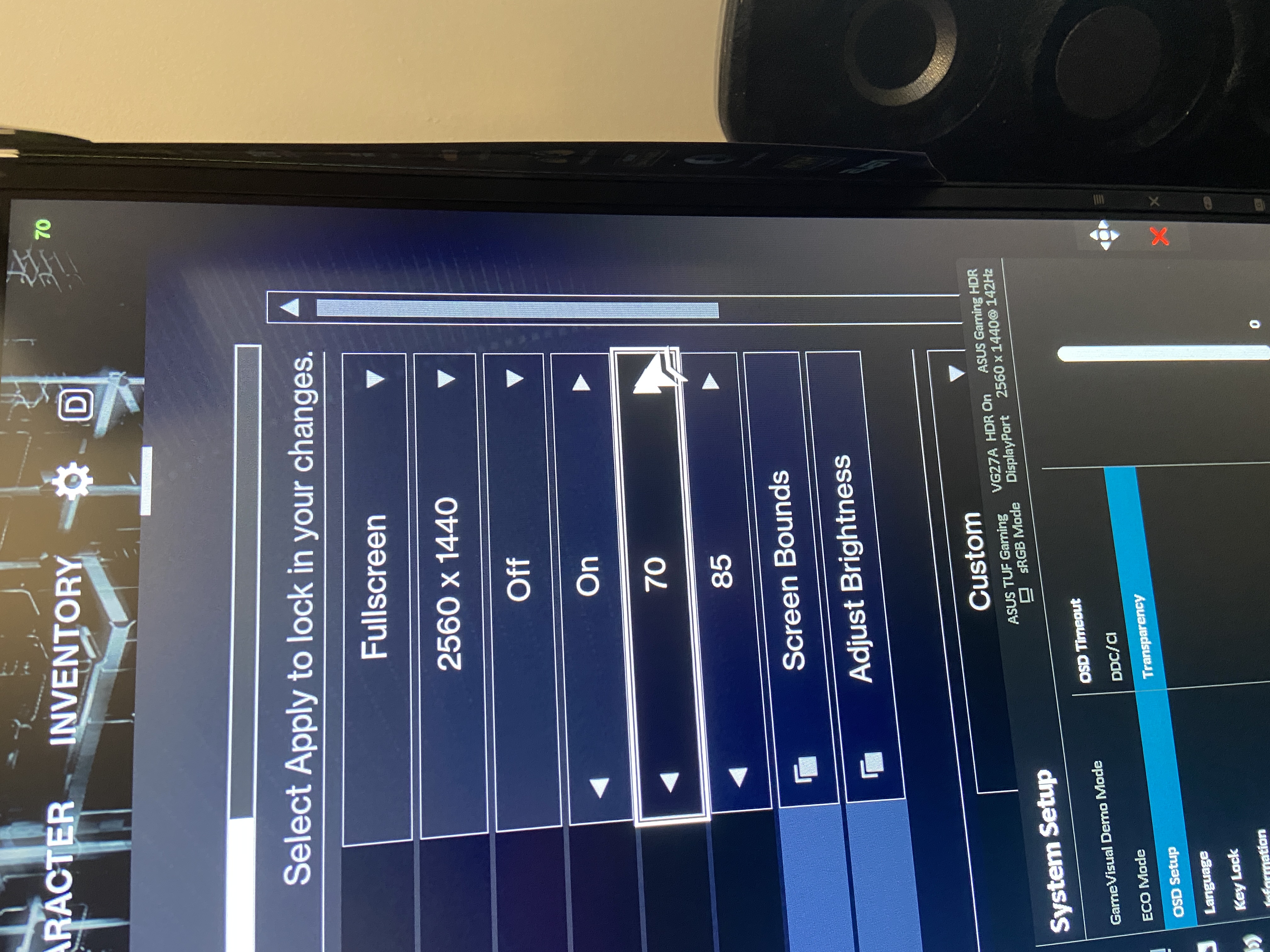

They FPS is green top right and bottom right is he. They match exactly but the gist is doubling below 70fps and as it above.
That's normal. Just because the monitor can do 48Hz does not mean that the GPU driver will choose to make use of that. If the driver thinks it's better to start LFC at 70hz, then you'll see this behavior.
Maybe. The reason LFC can be engaged at higher Hz might have something to do with ghosting, but it could be something else as well (like avoiding brightness changes.)
