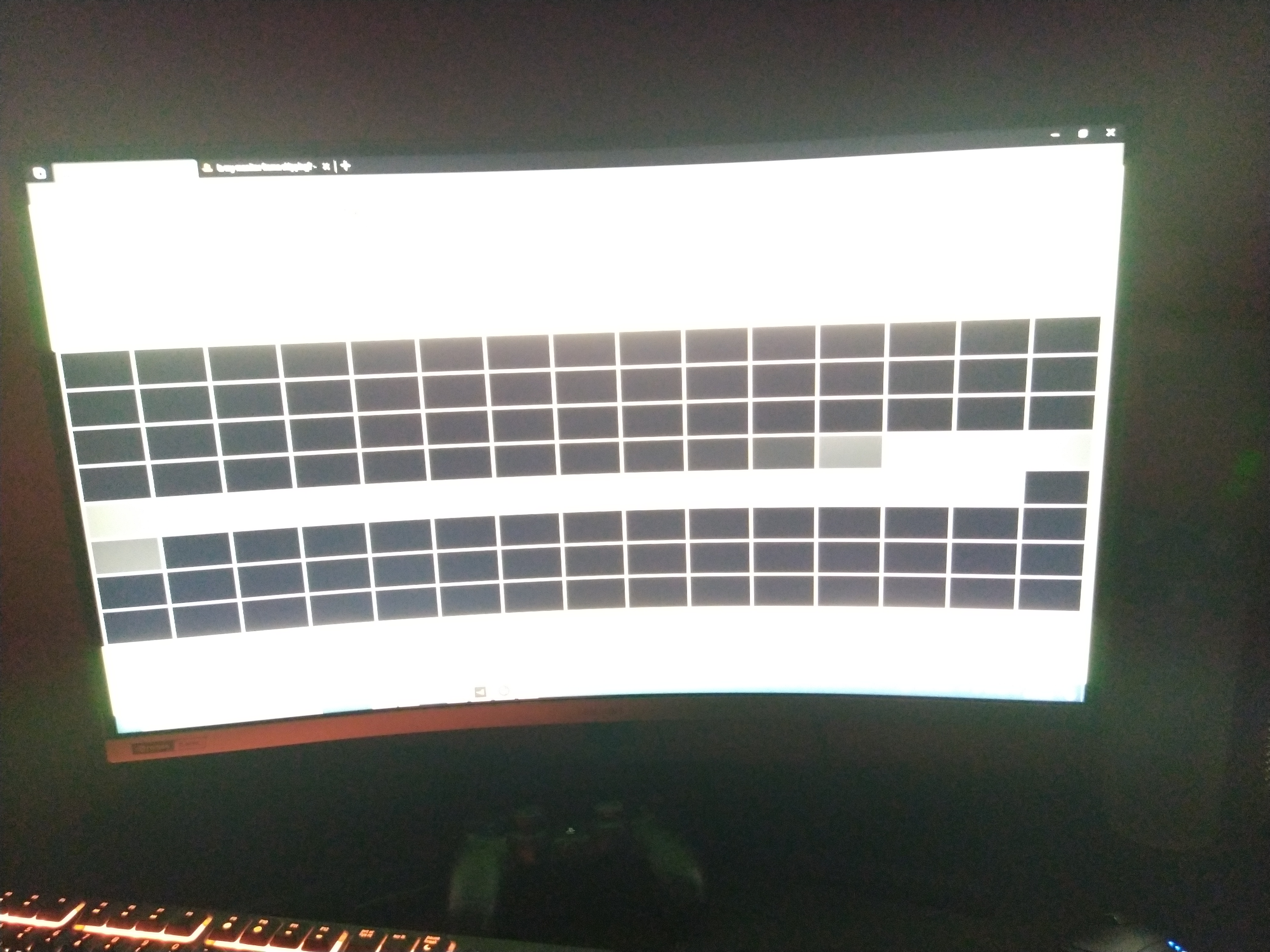

I just want to make sure that my monitor is working like it's supposed to. When I play csgo,my frames sometimes skip and it messes up my aim.please help me out:)

At the moment -- your question is unanswerable -- Please take longer camera exposures. It's exposing only 2 or 3 refresh cycles which is not enough to tell you whether or not your monitor is frame skipping.
If you can't adjust camera, or don't know how to, please temporarily adjust monitor brightness downwards, to make sure you capture at least 10 or 15 squares minimum. The camera will automatically take longer exposures in dimmer light.
Post the pictures, and thank you!

Here is the best picture that I could get

tev wrote:
29 Jun 2021, 02:14
That looks like frame skipping to me. The second to last box is black.

RealNC wrote:
29 Jun 2021, 05:42
tev wrote:
29 Jun 2021, 02:14
It might be -- but...
One frame got skipped but the photo is a little too overexposed to show if it's a READY (green) or a browser dropped frame.
Would it be possible to use a different camera (e.g. iPad or Android or iPhone), and/or to dim the monitor brightness even further and/or download a 3rd party camera app that lets you use a very low ISO value (e.g. ISO 80)?
