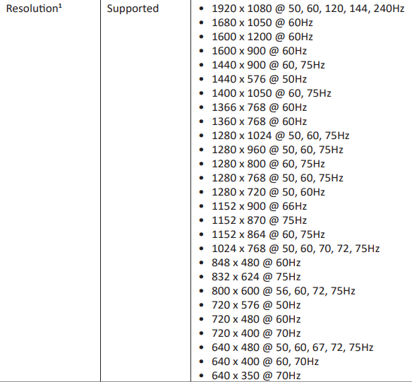

Post by disq » 01 Jul 2021, 17:39
Will we be able to use display scaling with this monitor for resolutions < than 1080p at max refresh rate? Either via HDMI or DisplayPort

disq wrote: ↑
01 Jul 2021, 17:39
I have only tested 4K 60 Hz -- and yes, XG2431 supports 4K 60Hz input. Obviously, it scales it down to 1080p 60Hz but it works.
For max-Hz, I doubt it. I have not tested 1440p or 4K at higher Hz, the cable bandwidth is the huge limiting factor. I suspect you will be able to get a little higher, but not all the way to 240 Hz. It is not a feature most gaming monitors is able to do.
disq
Posts: 65
Joined: 10 Oct 2018, 16:05
Re: [Blur Busters Approved XG2431 - 24" 240Hz IPS] ViewSonic unveils monitors for 2021 (The new 240Hz 24" king?)
Post by disq » 01 Jul 2021, 17:53
01 Jul 2021, 17:51
disq wrote: ↑
01 Jul 2021, 17:39
I have only tested and XG2431 supports 4K 60Hz input. Obviously, it scales it down to 1080p 60.
I meant resolutions lower than 1080p. Will it do, say, 1728x1080 or 1680x1050 at 240Hz?
On the manual posted few posts back, i can only see this:
I'm talking about "true" scaling, where for example, you use CRU to create a custom resolution and not nvidia with the "Automatic" standard where it keeps native resolution values
[Chief Blur Buster's Note: These are just the modes ViewSonic officially tested and validated. The monitor is able to sync to thousands of different custom Hz and custom resolutions that are not listed.]
Posts: 12299
Post by Chief Blur Buster » 01 Jul 2021, 18:05
disq wrote: ↑
01 Jul 2021, 17:53
I meant resolutions lower than 1080p. Will it do, say, 1728x1080 or 1680x1050 at 240Hz? On the manual posted few posts back, i can only see this:
It should. I tested various odd resolutions such as 1440x1080 and 3840x2160 and 1920x1078 -- the monitor will accept these signals.
For 1920x1080, it can do any fixed-Hz refresh rate in literally 0.001Hz increments from ~48Hz through ~240Hz -- with strobing supported from ~59Hz to 240Hz. I tested numerous sample oddball Hz's and they all worked as long as I correctly derived from an existing mode via ToastyX CRU (for monitor scaled) and NVIDIA CRU (for GPU scaled). And Large Vertical Totals are supported on this panel, too.
These are just the modes that ViewSonic "officially" tested, but I personally tested custom resolutions and custom Hz.
As a general rule of thumb, FreeSync support on any panel usually means custom fixed-Hz support (in the FreeSync range) and custom large VT support / Quick Frame Transport for fixed-Hz (with VTs similar to what FreeSync uses for a specific Hz).
The panel scaler/TCON needed to be flexible to support FreeSync / G-SYNC Compatible, which incidentally means vastly better flexibility in untested custom-fixed-Hz support on modern panels.
