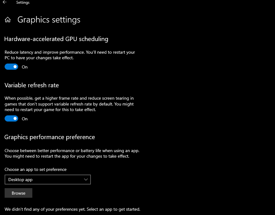

Graphic Settings:
graphics settings.png (27.24 KiB) Viewed 19531 times
ill using this because Melody and Felipe mean its good.
I dont use FortniteClient-Win64-Shipping.exe with High performance Option because i dont feel any difference and my FPS are Stable no drops.

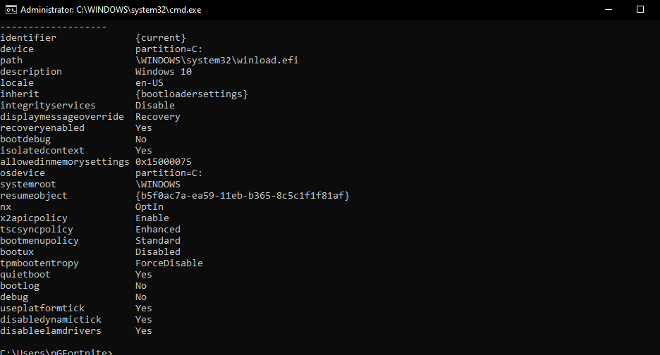

timer Resolution i also dont using same like bcdeit
bcdedit enum.png (22.65 KiB) Viewed 19531 times
settings
but when i checkes now bcdedit enum some settings in. Maybe Felipe make this for me its a Guy he have good Tweaking reviews and i ask him for Tweak my clean windows installation. overall all feel good but i have in Fortnite some Mouse and Keyboard input delay.. i try post Videos but forum dont let me :(
