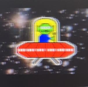

This is my XL2546K with the same test.
I don't have motion pursuit images of the VG259QM but it struggled a little bit with dark transitions with ELMB (but it's still better than unstrobed)
Imo the XG2431 looks better than my VG259QM when strobing.
