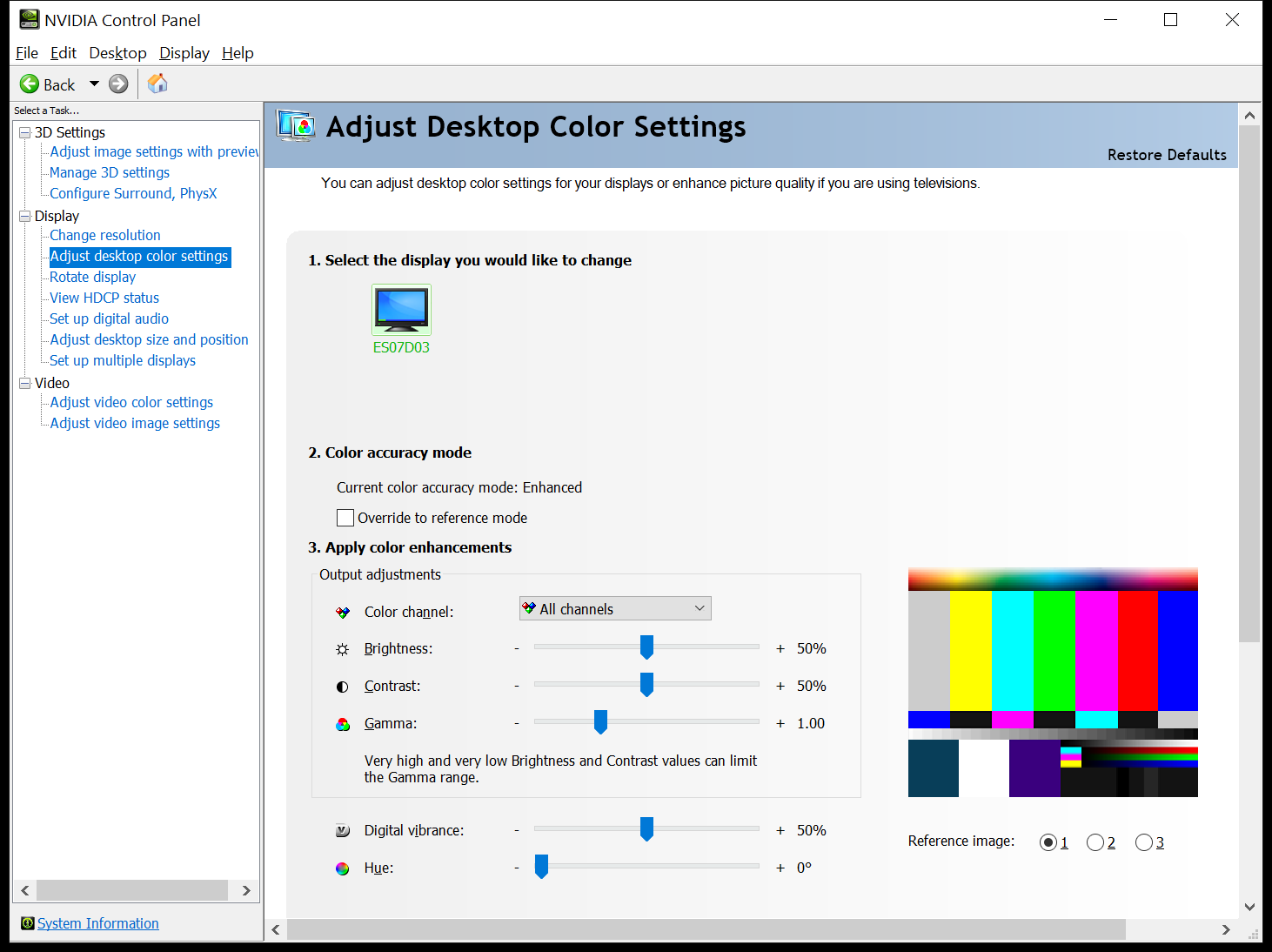

Does the XG2431 have any Gamma adjustments? I'm using it side-by-side with the BenQ XL2546K and I think it actually marginally beats it on motion blur reduction at a similar brightness level, but the colors are so dark (independent of brightness). If I could tick up the overall Gamma by 1 or 2 levels it would be perfect, but right now the shadows and dark colors are so dark it makes using it as an eSports monitor difficult. The BenQ has just as good of colors but it's just noticeably brighter without actually being backlit brighter (if that makes sense). Going on Normal or Light on the XG2431 makes the screen overall brighter (too bright) but doesn't actually fix the color issue.
why not adjust gamma in nvidia control panel?
So apparently you actually cannot adjust any of the settings via Nvidia control panel... perhaps something with the BB utility locks all of that out?
I'm able to adjust gamma and digital vibrance in nvidia control panel with xg2431
While PureXP is on? Because I cannot.
I believe they're referring to NVIDIA Control Panel's Gamma setting.
This works with PureXP.
Generic advice for gamma on all models of monitors:
Adjust Contrast/Brightness/RGB Gains/etc via monitor OSD instead (don't use NVCP), but where Gamma is missing from the monitor, adjust gamma via the NVIDIA Control Panel.
Ahh because I was duplicating the displays on both monitors I could only adjust the BenQ and not the XG2431... what a silly mistake... I'll run them extended and adjust and see if I find a setting with the XG2431 that works best. Although PureXP+ Normal, 80 contrast, and black stabilizer 60 looked pretty good.
