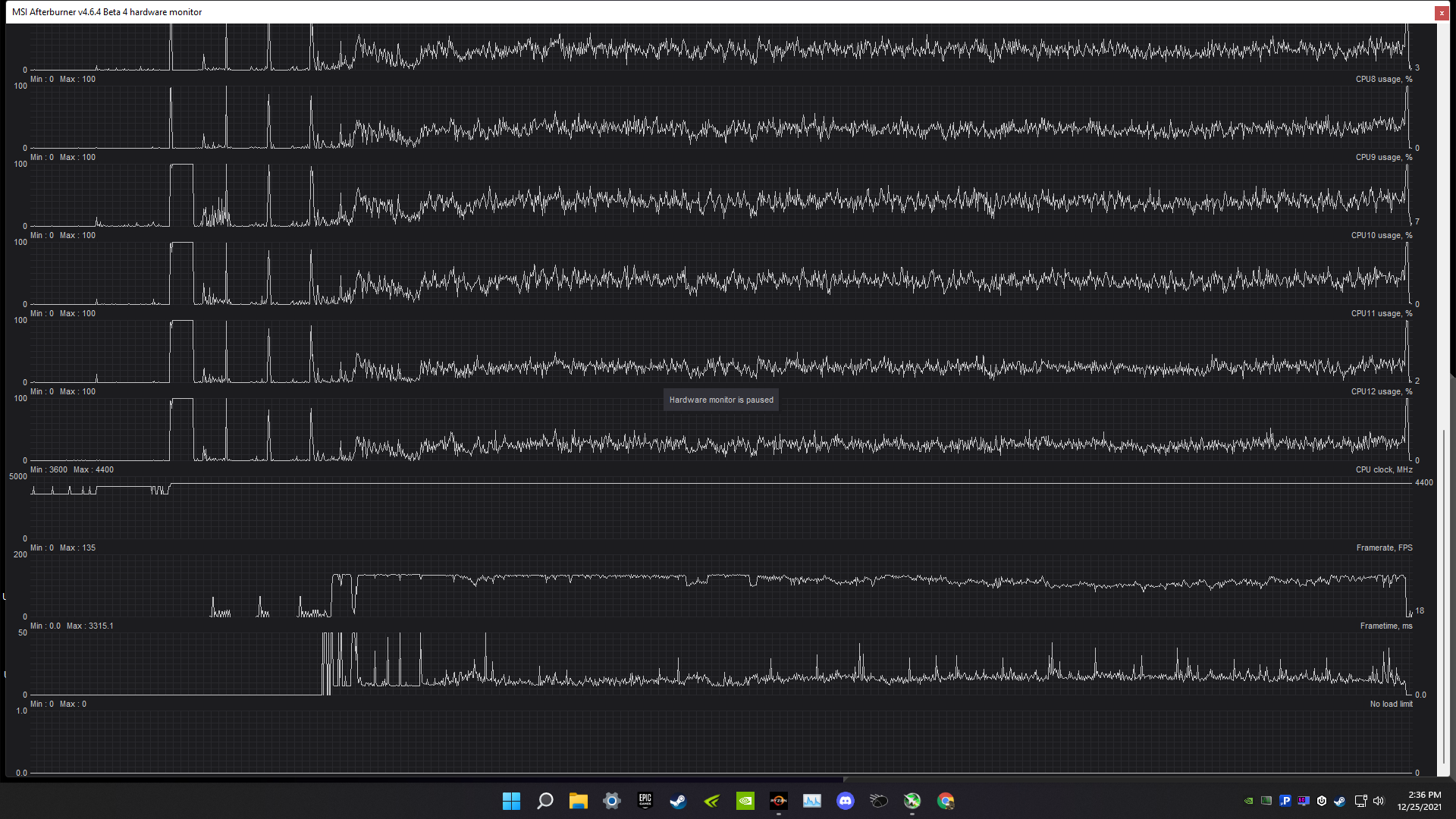

frametime spikes
frametime spikes

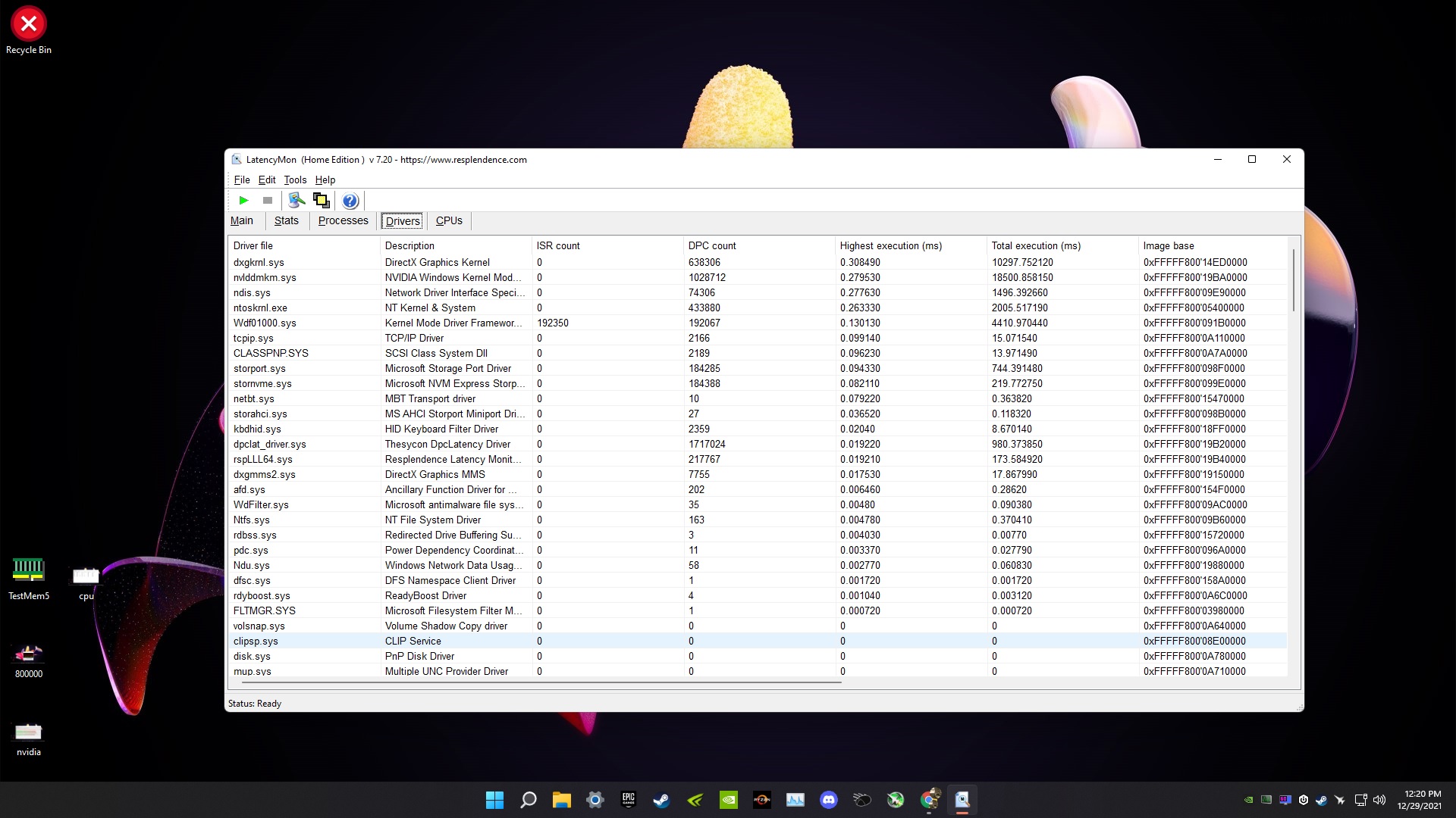

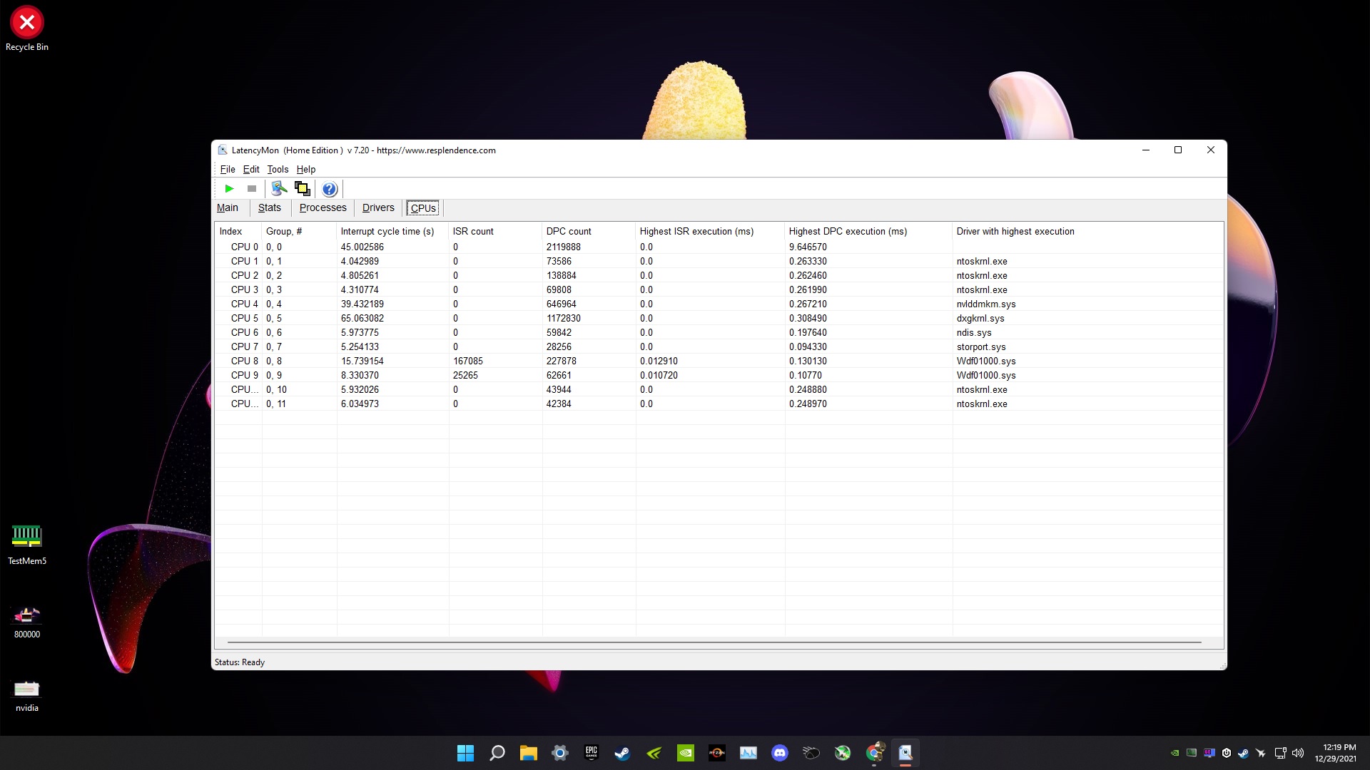

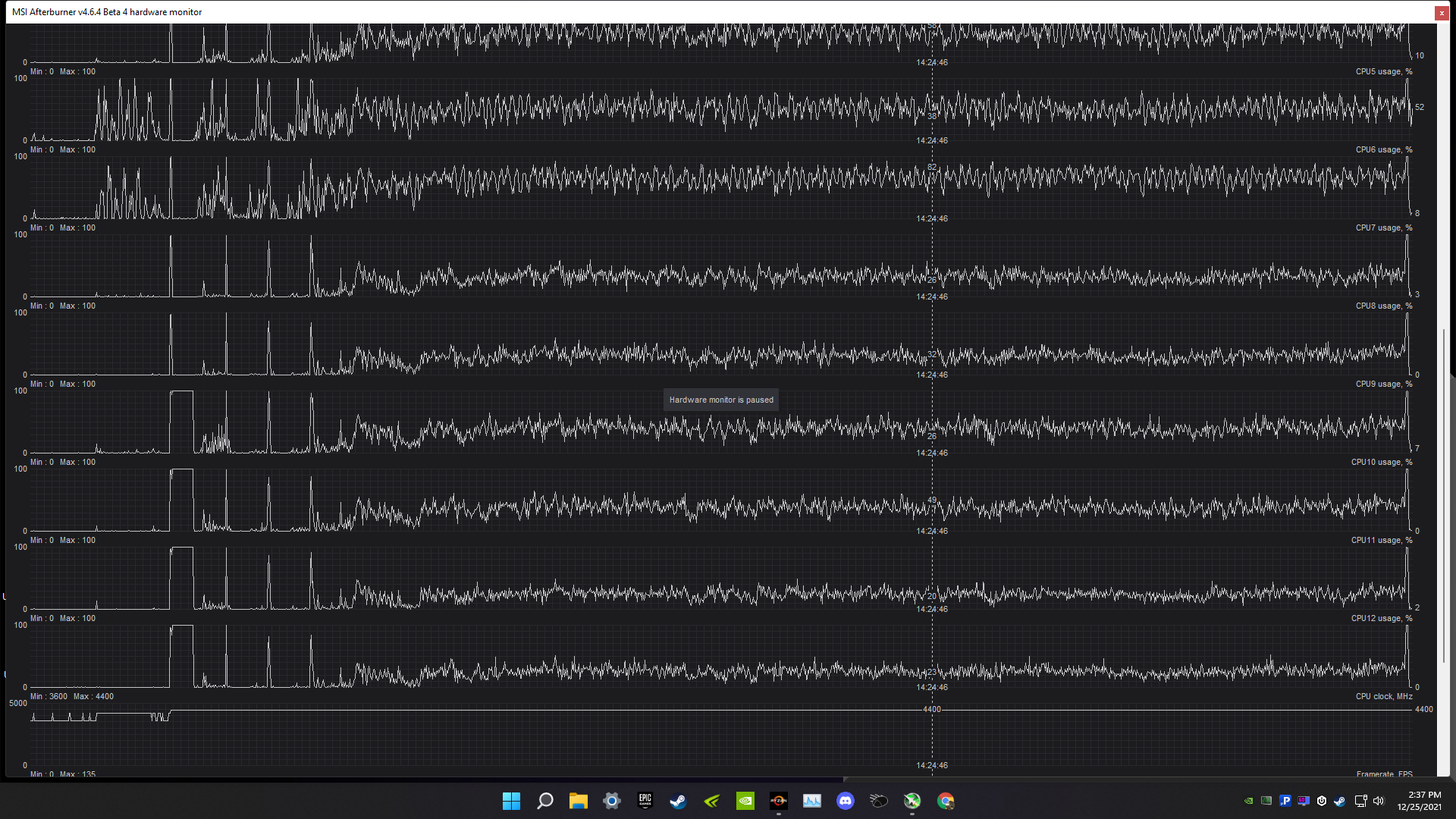

latency mon shows that kernal timer latency is high but doesnt say how to fix it.i get 10-50ms frametime spikes in all games online/singleplayer. most of them are when going in a new area or loading level or a granade goes off generated by sound. ive tried a lot of things bios tweaks. fresh instals windows 10/11. tried optimizations etc. overclock/undervoltage.smt on off. xpm on off. bios game mode on off.c states disabled. ultimate powerplan others deleted.all drivers up to date. amd chipset drivers tried unnistaling them tried without them no change.when the stutter happens the gpu sage goes to 0% a spike in cpu usage and frame time jumps to 10-50ms i get a visual stutter sound cut out and then everthing goes back to normal. ive changed ssd. psu. ram. gpu. built pc outside the case. disconected usb devices. been batteling this for months now. maybe its just a cpu bottlenck that im facing here? any help or idea how to fix this would be nice thx.
cpu; ryzen 5 3600
gpu: 1080ti strix
ram: gskil trident z 3200mzh cl14
ssd: 1t 980 m.2
mb: b450m mortar max
psu: rm850x
temps undear load doesnt go over 60c
cpu; ryzen 5 3600
gpu: 1080ti strix
ssd: 1t 980 m.2
psu: rm850x
- cpu 6-12 core.png (256.71 KiB) Viewed 17037 times
- Untitled.png (72.74 KiB) Viewed 17037 times
- frametime 40-50ms.png (216.01 KiB) Viewed 17037 times

LatencyMon was originally intended for troubleshooting real-time audio issues (like for studio recording programs, etc), not to run alongside a demanding game instance, so it's results should always be taken with a grain of salt in these scenarios.
50ms or under frametime spikes across games is within the expected norm, and can have numerous causes, many of which aren't avoidable and, assuming the system in question doesn't have any other underlying issues, are typically triggered by engine bottlenecks and/or the simple fact that some frames will always take longer than a single refresh cycle to render, which will create stutter due the previous frame repeating once or more while waiting for the next to be ready.
Look at my sig specs. I have the latest gear (with no know EMI issues). I've been playing Guardians of the Galaxy today, for instance, and I get up to 50ms spikes (sometimes above) with scene changes, auto saves, new area loading (etc), and not infrequently. It's the engine. It varies by game; in some I have minor, infrequent frametime spikes, in others, I have moderate and frequent.
While you can reduce spikes, you usually can't eliminate them, especially with the majority of current gen games. The most underestimated and overlooked factor when troubleshooting frametime spikes is the quirks and limitations of the game engine itself (including netcode, shader compilation, I/O access, etc), and there aren't that many efficient engines out there.
That said, the sound "audibly" cutting out during frametime spikes is the only thing that seems potentially abnormal in your case, but you didn't share your audio configuration at all, and whether these spikes were reduced if you unplugged your audio devices and disabled them in the OS.

Re: frametime spikes
I noticed in your framerate and frametime graph that you seem to be playing with an uncapped framerate?nuk_won wrote: ↑28 Dec 2021, 10:07maybe u are right that im trying to fix something that nobody can fix. maybe im just unlucky that im so sensitive to these frame time spikes. did a little test i let my whife play the game and she didnt notice any stutter but i did so a lot of people dont even see them. did try varios mouse pooling rates and even got a xtrify MZ1 tht doesnt use any software
Have you tried capping to something your system can sustain 99% in the given game with RTSS or Nvidia Max Frame Rate and checking your graphs then? That should eliminate all of the non-frametime spike variances, and leave only the start up, load time, I/O, and CPU/GPU spikes visible, which may give a better idea on whether you're experiencing anything out of the ordinary.

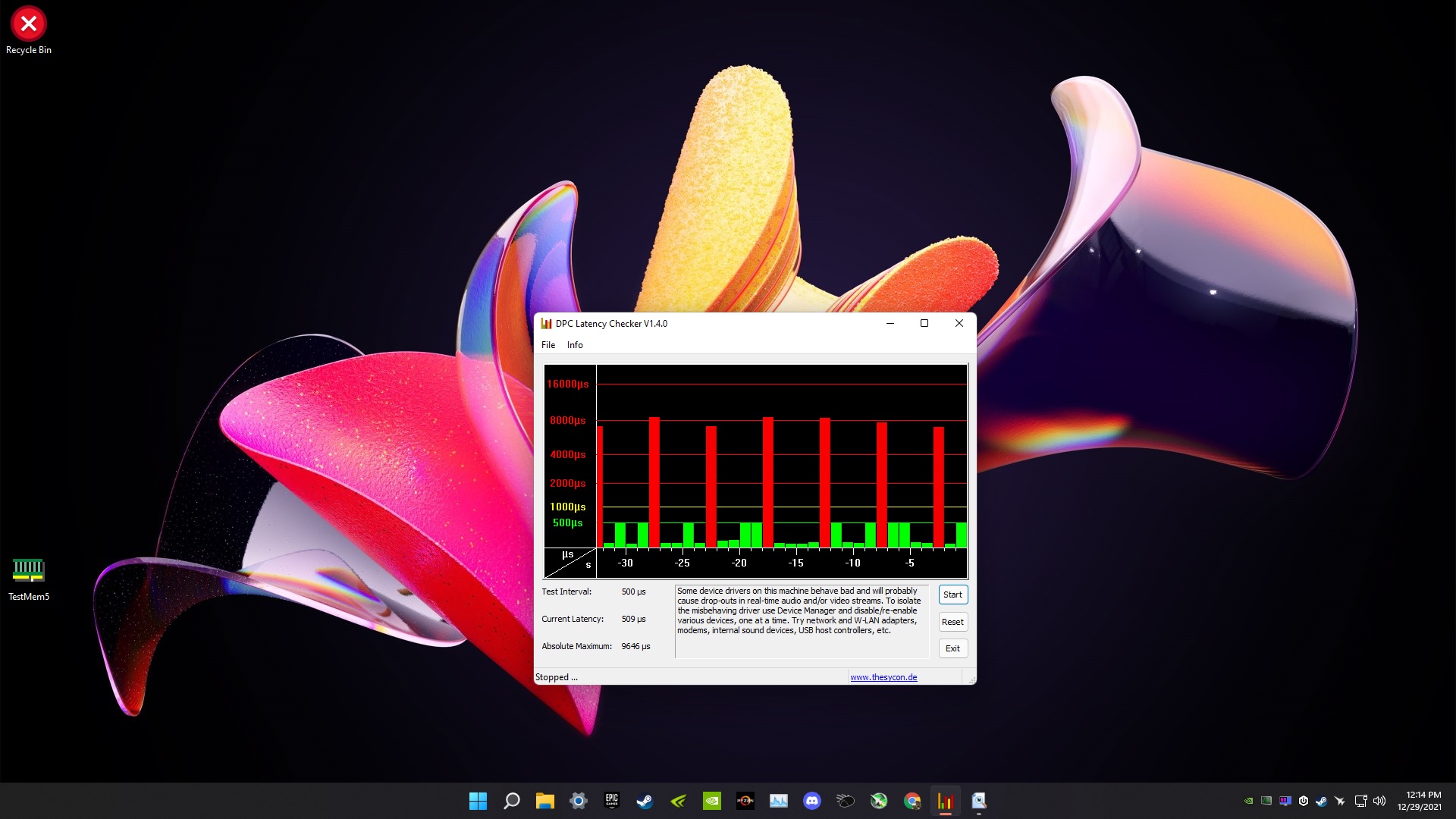

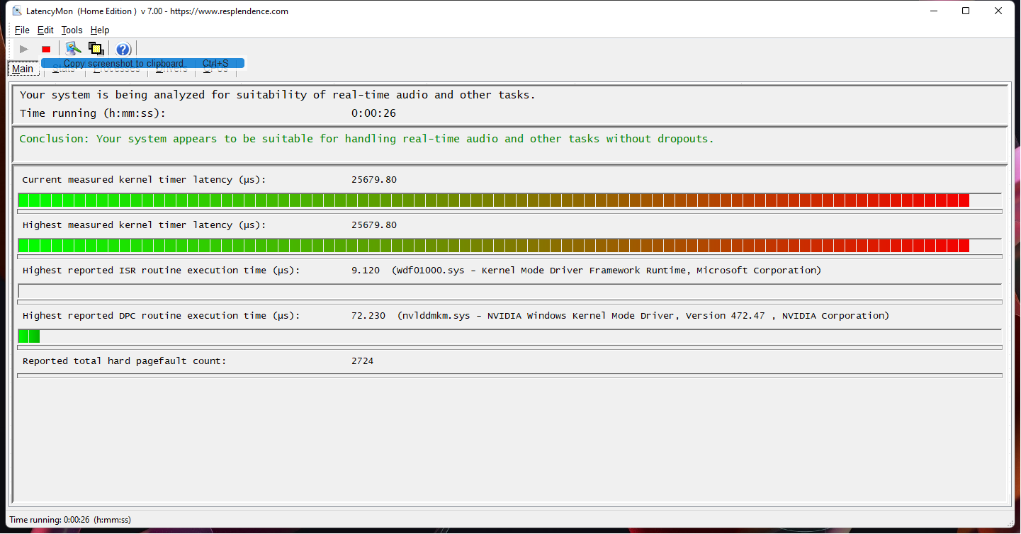

Hello nuk_won,nuk_won wrote: ↑26 Dec 2021, 13:22latency mon shows that kernal timer latency is high but doesnt say how to fix it.i get 10-50ms frametime spikes in all games online/singleplayer. most of them are when going in a new area or loading level or a granade goes off generated by sound. ive tried a lot of things bios tweaks. fresh instals windows 10/11. tried optimizations etc. overclock/undervoltage.smt on off. xpm on off. bios game mode on off.c states disabled. ultimate powerplan others deleted.all drivers up to date. amd chipset drivers tried unnistaling them tried without them no change.when the stutter happens the gpu sage goes to 0% a spike in cpu usage and frame time jumps to 10-50ms i get a visual stutter sound cut out and then everthing goes back to normal. ive changed ssd. psu. ram. gpu. built pc outside the case. disconected usb devices. been batteling this for months now. maybe its just a cpu bottlenck that im facing here? any help or idea how to fix this would be nice thx.
cpu; ryzen 5 3600
gpu: 1080ti strix
ssd: 1t 980 m.2
psu: rm850x
If you're really interested in getting your Kernel latency down to 1ms try to download an application called DPC Latency Checker V1.4.0, for some reason that was the only application that I found to force the kernel latency timer down to around the 1ms mark, with timer resolution I was able to force it even lower, hovering around the 0.05-0.15ms latency mark. But I don't think that I noticed anything changing to the extent of my being super hyped about it or to keep it on all the time.
The application does not even need to be running btw, just open it and watch your Kernel Timer go down
I also attached a picture that shows how the kernel timer would be with the application on + ISLC Timer Resolution set to 0.51! Also worth to mention that I had Microsoft edge with 8 tabs, Riots Client, Valorant Game, G Skill Trident and my audio interface app all running in the background.
Hope it helps you out mate! Let me know
- LatencyMon.jpg (319.25 KiB) Viewed 16767 times

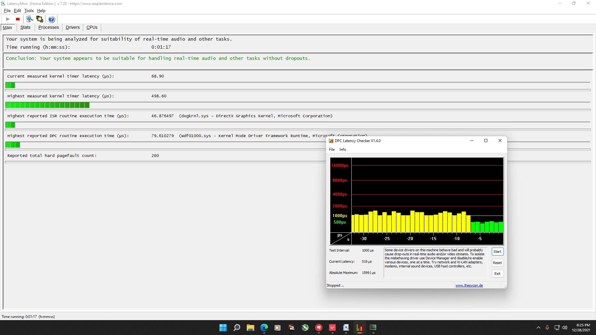

thx i will try it. when i get homeThatweirdinputlag wrote: ↑28 Dec 2021, 13:29Hello nuk_won,nuk_won wrote: ↑26 Dec 2021, 13:22latency mon shows that kernal timer latency is high but doesnt say how to fix it.i get 10-50ms frametime spikes in all games online/singleplayer. most of them are when going in a new area or loading level or a granade goes off generated by sound. ive tried a lot of things bios tweaks. fresh instals windows 10/11. tried optimizations etc. overclock/undervoltage.smt on off. xpm on off. bios game mode on off.c states disabled. ultimate powerplan others deleted.all drivers up to date. amd chipset drivers tried unnistaling them tried without them no change.when the stutter happens the gpu sage goes to 0% a spike in cpu usage and frame time jumps to 10-50ms i get a visual stutter sound cut out and then everthing goes back to normal. ive changed ssd. psu. ram. gpu. built pc outside the case. disconected usb devices. been batteling this for months now. maybe its just a cpu bottlenck that im facing here? any help or idea how to fix this would be nice thx.

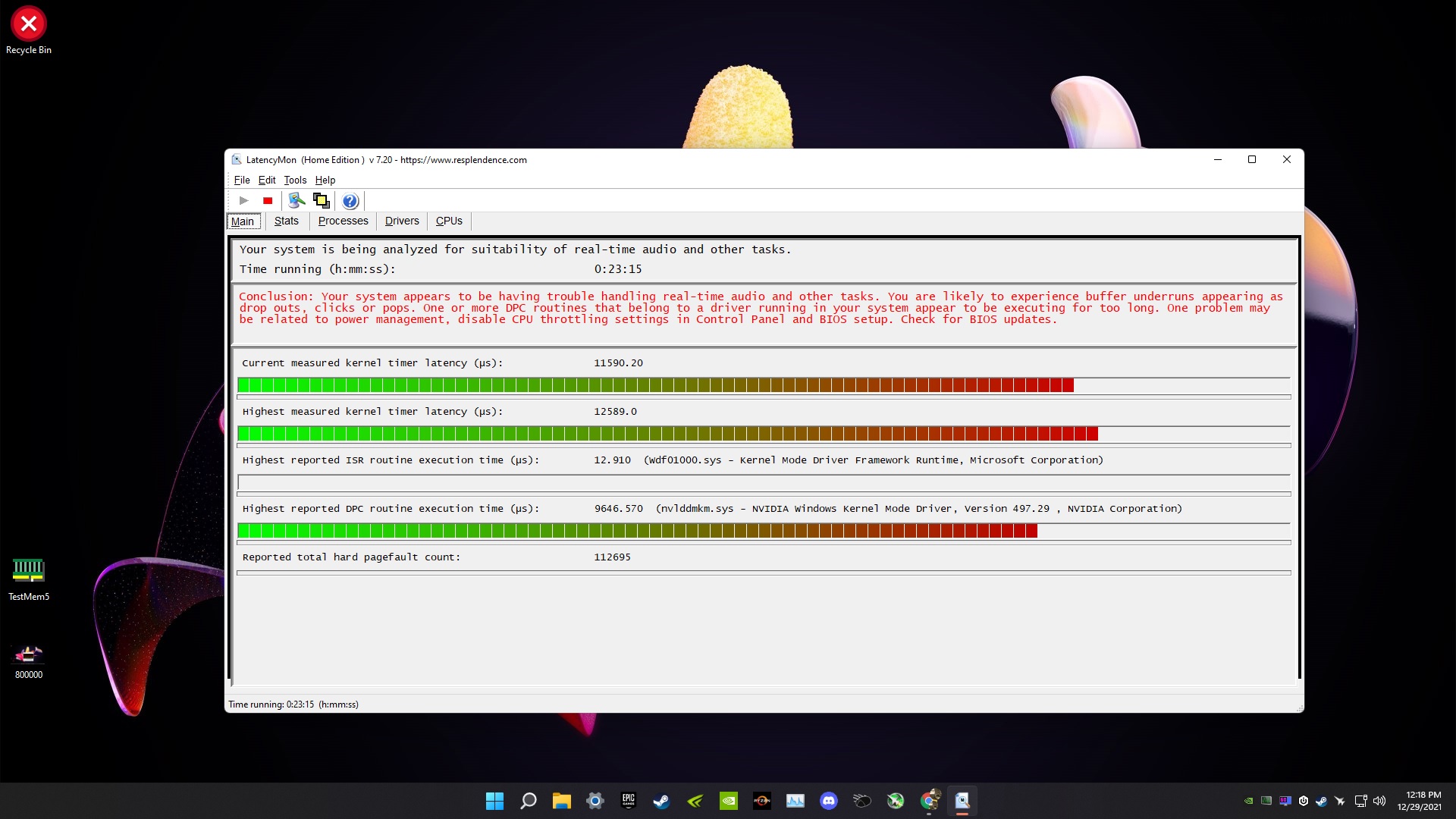

i download the DPC. i got them down but i know u are not suposted to run ion while gaming. i lunched the game and every time when there is a spike in game the DPC registers thaat and i dont know what is causing thatThatweirdinputlag wrote: ↑28 Dec 2021, 13:29Hello nuk_won,nuk_won wrote: ↑26 Dec 2021, 13:22latency mon shows that kernal timer latency is high but doesnt say how to fix it.i get 10-50ms frametime spikes in all games online/singleplayer. most of them are when going in a new area or loading level or a granade goes off generated by sound. ive tried a lot of things bios tweaks. fresh instals windows 10/11. tried optimizations etc. overclock/undervoltage.smt on off. xpm on off. bios game mode on off.c states disabled. ultimate powerplan others deleted.all drivers up to date. amd chipset drivers tried unnistaling them tried without them no change.when the stutter happens the gpu sage goes to 0% a spike in cpu usage and frame time jumps to 10-50ms i get a visual stutter sound cut out and then everthing goes back to normal. ive changed ssd. psu. ram. gpu. built pc outside the case. disconected usb devices. been batteling this for months now. maybe its just a cpu bottlenck that im facing here? any help or idea how to fix this would be nice thx.
cpu; ryzen 5 3600
gpu: 1080ti strix
ssd: 1t 980 m.2
psu: rm850x
The application does not even need to be running btw, just open it and watch your Kernel Timer go down! Why this application in specific? I have no idea, but if I had to guess, maybe it forces the system into some sort of a sensitive low latency mode state.
Hope it helps you out mate! Let me know![]()
- 800000.jpg (311.59 KiB) Viewed 16664 times
!!!!!!!!!!!!!!!!!!!!!!!!!!!!!!!!!!!!!!!!!!!!!!!!!!THIS WAS WHILE PLAYING A GAME!!!!!!!!!!!!!!!!!!!!!!!!!!!!!!!!!!!!!!!!!!!!!!!!!!!!!!!!!!!!!!!!nuk_won wrote: ↑29 Dec 2021, 05:17i download the DPC. i got them down but i know u are not suposted to run ion while gaming. i lunched the game and every time when there is a spike in game the DPC registers thaat and i dont know what is causing thatThatweirdinputlag wrote: ↑28 Dec 2021, 13:29Hello nuk_won,nuk_won wrote: ↑26 Dec 2021, 13:22latency mon shows that kernal timer latency is high but doesnt say how to fix it.i get 10-50ms frametime spikes in all games online/singleplayer. most of them are when going in a new area or loading level or a granade goes off generated by sound. ive tried a lot of things bios tweaks. fresh instals windows 10/11. tried optimizations etc. overclock/undervoltage.smt on off. xpm on off. bios game mode on off.c states disabled. ultimate powerplan others deleted.all drivers up to date. amd chipset drivers tried unnistaling them tried without them no change.when the stutter happens the gpu sage goes to 0% a spike in cpu usage and frame time jumps to 10-50ms i get a visual stutter sound cut out and then everthing goes back to normal. ive changed ssd. psu. ram. gpu. built pc outside the case. disconected usb devices. been batteling this for months now. maybe its just a cpu bottlenck that im facing here? any help or idea how to fix this would be nice thx.

Your system appears to be having trouble handling real-time audio and other tasks. You are likely to experience buffer underruns appearing as drop outs, clicks or pops. One or more DPC routines that belong to a driver running in your system appear to be executing for too long. One problem may be related to power management, disable CPU throttling settings in Control Panel and BIOS setup. Check for BIOS updates.
LatencyMon has been analyzing your system for 0:23:19 (h:mm:ss) on all processors.

MEASURED KERNEL TIMER LATENCIES
_________________________________________________________________________________________________________
This value represents the maximum measured latency of a perodically scheduled kernel timer.
Highest measured kernel timer latency (µs): 12589.0
REPORTED ISRs
Interrupt service routines are routines installed by the OS and device drivers that execute in response to a hardware interrupt signal.
Highest ISR routine execution time (µs): 12.910
Driver with highest ISR routine execution time: Wdf01000.sys - Kernel Mode Driver Framework Runtime, Microsoft Corporation
Highest reported total ISR routine time (%): 0.001663
Driver with highest ISR total time: Wdf01000.sys - Kernel Mode Driver Framework Runtime, Microsoft Corporation
Total time spent in ISRs (%) 0.001663
ISR count (execution time <250 µs): 192350
ISR count (execution time 250-500 µs): 0
ISR count (execution time 500-1000 µs): 0
ISR count (execution time 1000-2000 µs): 0
ISR count (execution time 2000-4000 µs): 0
ISR count (execution time >=4000 µs): 0
REPORTED DPCs
DPC routines are part of the interrupt servicing dispatch mechanism and disable the possibility for a process to utilize the CPU while it is interrupted until the DPC has finished execution.
Highest DPC routine execution time (µs): 9646.570
Driver with highest DPC routine execution time: nvlddmkm.sys - NVIDIA Windows Kernel Mode Driver, Version 497.29 , NVIDIA Corporation
Highest reported total DPC routine time (%): 0.096118
Driver with highest DPC total execution time: nvlddmkm.sys - NVIDIA Windows Kernel Mode Driver, Version 497.29 , NVIDIA Corporation
Total time spent in DPCs (%) 0.237731

CPU 4 ISR highest execution time (µs): 0.0
CPU 4 ISR total execution time (s): 0.0
CPU 4 ISR count: 0
CPU 4 DPC highest execution time (µs): 267.210
CPU 4 DPC total execution time (s): 10.391425
CPU 4 DPC count: 646964
CPU 5 Interrupt cycle time (s): 65.063083
CPU 5 ISR highest execution time (µs): 0.0
CPU 5 ISR total execution time (s): 0.0
CPU 5 ISR count: 0
CPU 5 DPC highest execution time (µs): 308.490
CPU 5 DPC total execution time (s): 19.596712
CPU 5 DPC count: 1172830
CPU 6 Interrupt cycle time (s): 5.973776
CPU 6 ISR highest execution time (µs): 0.0
CPU 6 ISR total execution time (s): 0.0
CPU 6 ISR count: 0
CPU 6 DPC highest execution time (µs): 197.640
CPU 6 DPC total execution time (s): 0.205412
CPU 6 DPC count: 59842
CPU 7 Interrupt cycle time (s): 5.254133
CPU 7 ISR highest execution time (µs): 0.0
CPU 7 ISR total execution time (s): 0.0
CPU 7 ISR count: 0
CPU 7 DPC highest execution time (µs): 94.330
CPU 7 DPC total execution time (s): 0.085847
CPU 7 DPC count: 28256
CPU 8 Interrupt cycle time (s): 15.739154
CPU 8 ISR highest execution time (µs): 12.910
CPU 8 ISR total execution time (s): 0.235028
CPU 8 ISR count: 167085
CPU 8 DPC highest execution time (µs): 130.130
CPU 8 DPC total execution time (s): 3.701164
CPU 8 DPC count: 227878
CPU 9 Interrupt cycle time (s): 8.330370
CPU 9 ISR highest execution time (µs): 10.720
CPU 9 ISR total execution time (s): 0.044386
CPU 9 ISR count: 25265
CPU 9 DPC highest execution time (µs): 107.70
CPU 9 DPC total execution time (s): 0.686464
CPU 9 DPC count: 62661
CPU 10 Interrupt cycle time (s): 5.932027
CPU 10 ISR highest execution time (µs): 0.0
CPU 10 ISR total execution time (s): 0.0
CPU 10 ISR count: 0
CPU 10 DPC highest execution time (µs): 248.880
CPU 10 DPC total execution time (s): 0.165602
CPU 10 DPC count: 43944
CPU 11 Interrupt cycle time (s): 6.034973
CPU 11 ISR highest execution time (µs): 0.0
CPU 11 ISR total execution time (s): 0.0
CPU 11 ISR count: 0
CPU 11 DPC highest execution time (µs): 248.970
CPU 11 DPC total execution time (s): 0.301127
CPU 11 DPC count: 42384
- nvidia.jpg (342.82 KiB) Viewed 16663 times
- drivers.jpg (447.75 KiB) Viewed 16663 times
- cpu.jpg (289.33 KiB) Viewed 16663 times
it looks like the Nvidia driver is not enjoying its time on your PC. It could be a lot of things tbh, from power delivery to your card, to the card heating up, a settings problem or a driver issue in general for your card, even running something like HWinfo or MSI afterburner during the DPC latency checker would cause DPC spikes and issues.
So the kernel timer did not go down at all after opening the latency checker? thats weird it works for me and i am on windows 11. Anyways, have you ever tried locking your GPU frequency at a certain speed? from MSI afterburner press "CTRL + F" then pick the frequency you want "make sure its something that your card can actually maintain without overheating or anything" then press "L or K i can't remember" you'll see a dotted vertical line appear, after that you can just go back to MSI Afterburner's main interface and hit Apply. This will force a certain frequency and voltage to be applied all the time to your gpu, which will prevent it from clocking up or down from whatever you have previously set. You can close afterburner afterwards the settings will be saved for your session until you restart your PC "to be sure just check your gpu clock speed after closing MSI afterburning with something else like HWinfo".
Let me know how it goes..
