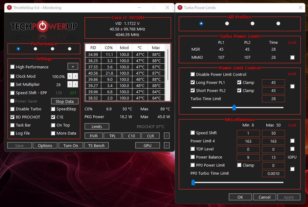

@akylen: Here, so basically I've disabled power limit control in the TPL menu, and changed the values of PL1 and PL2. Originally they were PL1- 45W and PL2- 107W, so I ended up changing them both to 45W and clamped them such that they don't exceed them. Here is the attached picture

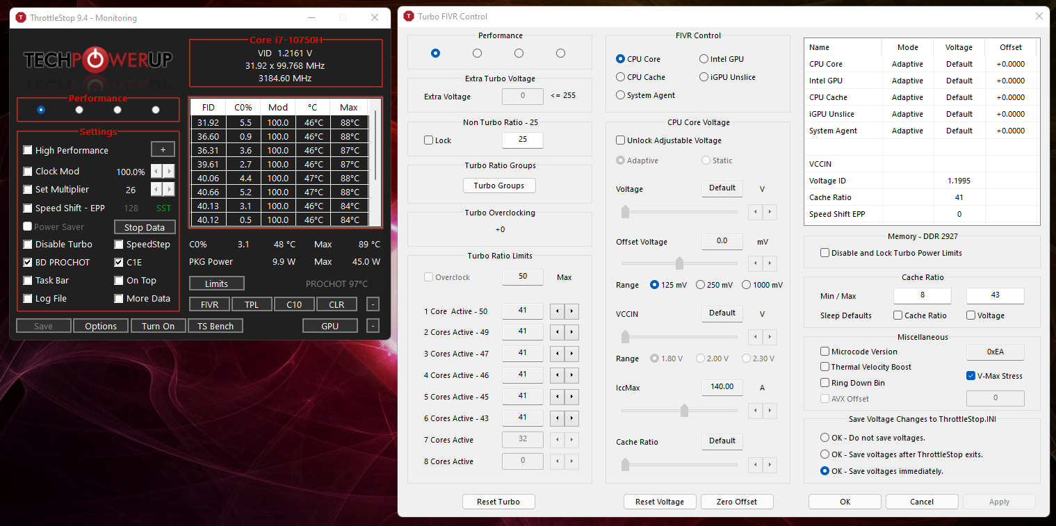

Furthermore, since my laptop had Turbo boost enabled by default, I went into the FIVR menu and changed the Turbo Ratio Limits, all of them to 41, such that they give me a max of 4.1GHz on all cores without thermal throttling. Pic attached here:

@Unreazz I did it through Throttlestop 9.4

@woodyfly I couldn't really change it through the BIOS, there's Intel's Extreme Tuning Utility and Throttlestop that I'm aware of that can do so as of now.
