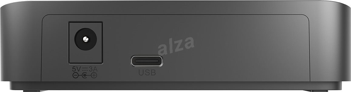

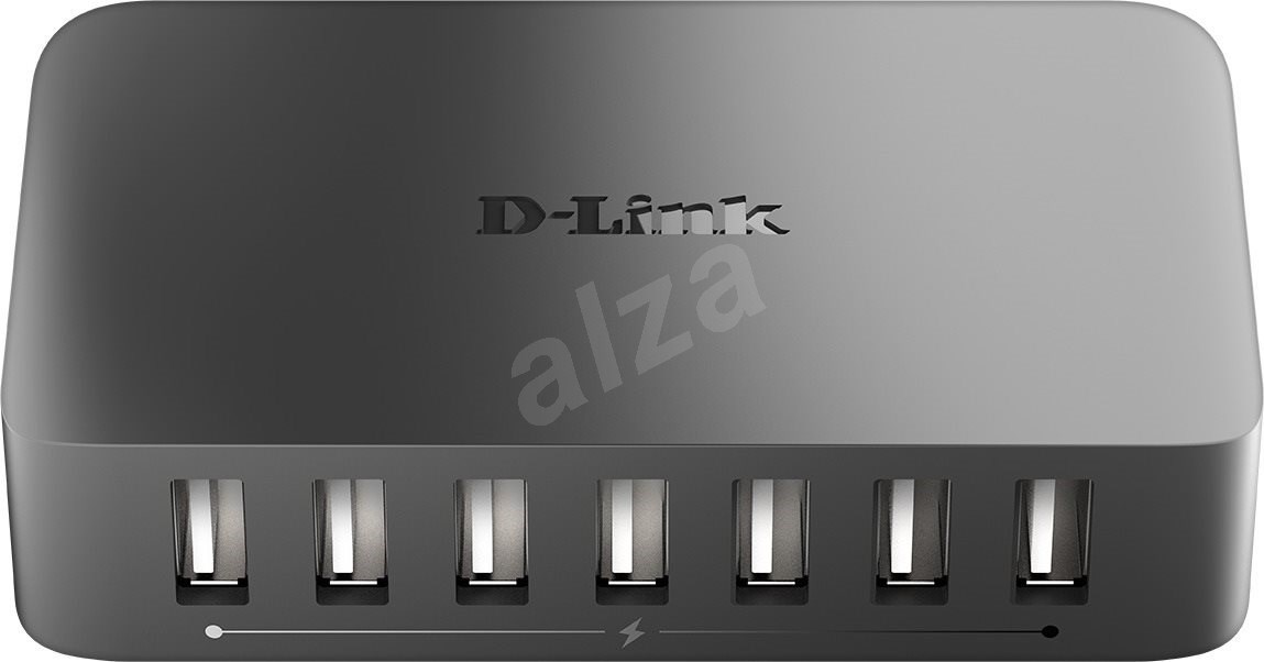

Find something strange and maybe this will solve mine input lag one day.... I purchase USB HUB D-Link it has its own power supply (5V 3A) when i try to plug in to PC usb (with headset on my head) the pc play the sound just when i touch the case - not solid plug in. So i discover that its sparking as on the video i add.(its not mine video but the sparks looks same its realy hard to record that)
When i play around with these sparks i am able to shut down RGB on the mouse with them and also my monitor go black.
If my appartmen is not able to operate simple adapter 5V 3A how regular 750W PSU can even work? To my knowledge they are the same just the PC one deliver more Amps and differnt voltage.
Did not find much on internet about it.
Video with sparks from USB

- ImgW.jpg (51.16 KiB) Viewed 7975 times
- ImgW (2).jpg (30.73 KiB) Viewed 7975 times
