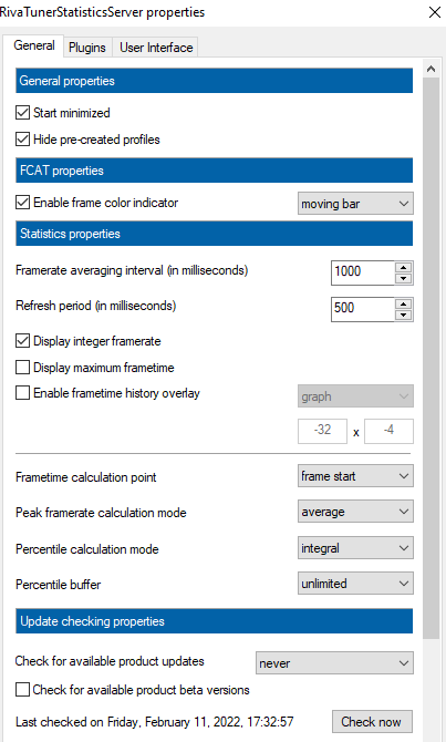

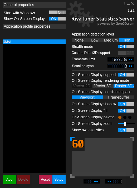

My game is Fortnite I love ULMB in creative everything is fine because I reach 240fps in normal arena rounds I unfortunately only reach with my current PC about 180-240fps and at 180 ULMB looks very very bad and it doesn't feel good either I read here that you can fix that with V-Sync (low input lag variant) I actually followed everything unfortunately 180fps still feel very bad and I don't get a clean picture like with 240fps at 240hz is that just normal or did I do something wrong
I pinned my RTSS settings
TestUFO refresh rate was 239,761
V-Sync ON (Nvidia Control Panel)
Thanks in advance for all replies

Vsync isn't gonna do anything for 180FPS ULMB. You'd have better luck trying to get 180Hz ULMB working instead. If the monitor can be coaxed to run 180Hz ULMB, that is.

So I have now set 180hz and set the RTSS limiter to 179.990 without V-Sync and found it very very good I took over my settings as explained could you check if everything is correct I pinned it
one more question i saw that it could recognize games as
hack i activated the stealth mode could i still get problems
in competitive games?
Thank you very much for the explanations
and the help

Shelful wrote:
11 Feb 2022, 13:49
You shouldn't use that unless you know what you're doing.
