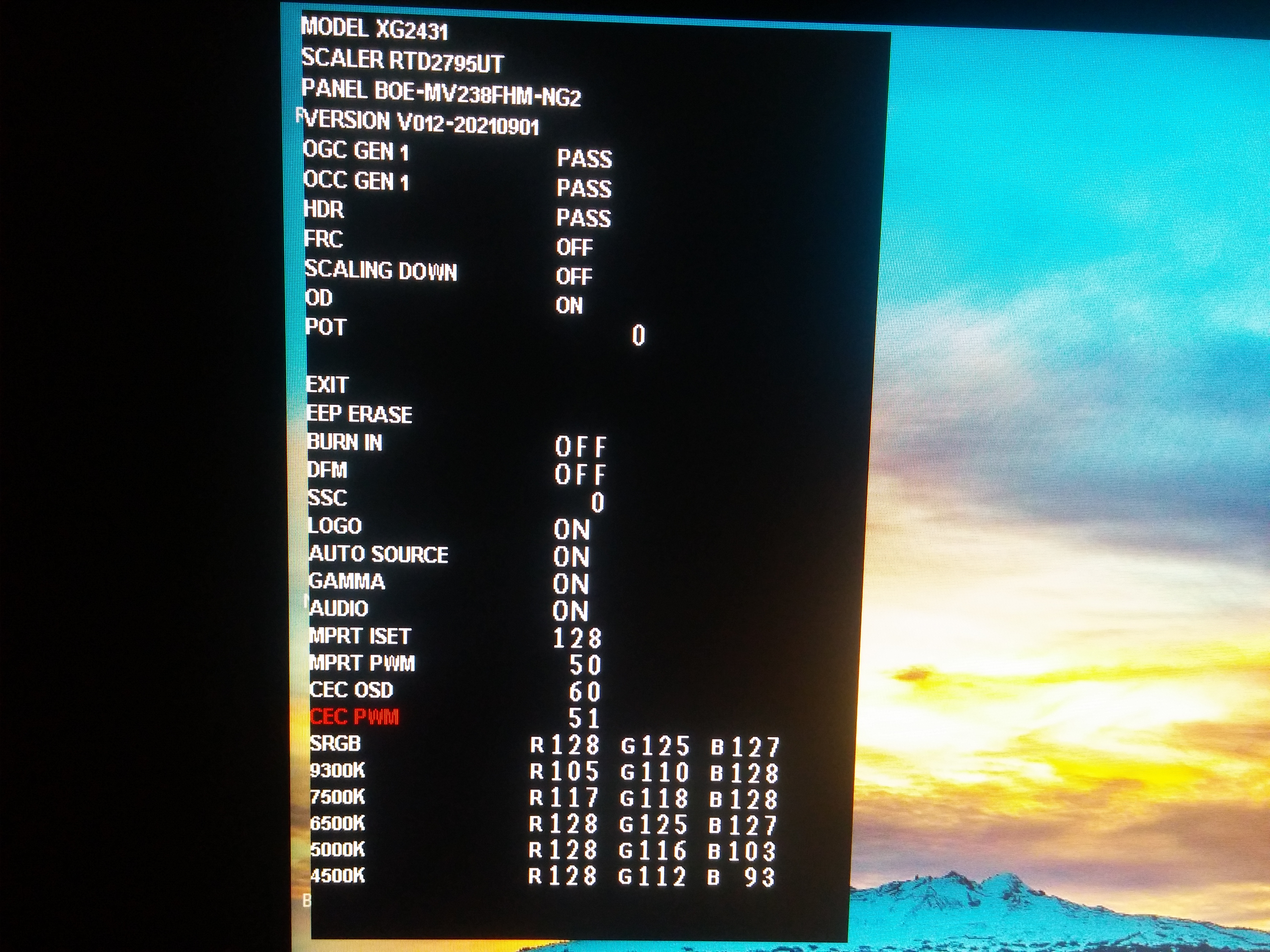

I found how to access the service menu. I had to press and hold the middle menu button (There are 5 menu buttons). Unfortunately, there is no indication of how long the backlight has been running.
Could that be causing the eyestrain some people are having?
What happens if you turn it on?
This monitor causes me eyestrain too. The 1st time i used the monitor, I blamed the eyestrain i got on normal tiredness. Today is my second time using the monitor and after spending those few minutes recording that video, I immediately got eyestrain. It's not tiredness cause i literally just woke up and i was feeling great before using the monitor.
I can't tag him.
What happens if you turn on "burn in" and then re-enter the factory menu? Do you have access to those options afterwards?
It seems strange that you have no access to the FRC or Overdrive (OD) setting there.

Still can't access those options above EXIT.Falkentyne wrote: ↑22 Apr 2022, 19:16Chief? Any word about this?Boomchakadah wrote: ↑22 Apr 2022, 18:02I can't turn it on. https://streamable.com/pybm3iFalkentyne wrote: ↑22 Apr 2022, 15:23If this is a 6 bit +Hi-FRC monitor, then why is FRC turned off?Boomchakadah wrote: ↑21 Apr 2022, 17:11
I can't tag him.
That BURN IN setting has 3 options, OFF, PICTURE CHECK, and USER BURN. When I select either of those two options and then re-enter the service menu, they get reverted back to OFF and all my OSD settings get reverted back to default.
I also tried turning on DFM too and the same thing happens.
By the way, POT was on 5 before, now it's on 0 and i don't know how to put it back to 5. (i don't even know what that option does.)
EDIT: I believe ''POT'' means Power On Time/ how long the backlight has been running in hours.

Are you using DisplayPort or HDMI? Try using HDMI, I've read that HDMI does much better with VT tweak, perhaps the monitor will do 6bit+frc through HDMI instead of DP?Boomchakadah wrote: ↑22 Apr 2022, 20:32Still can't access those options above EXIT.Falkentyne wrote: ↑22 Apr 2022, 19:16Chief? Any word about this?Boomchakadah wrote: ↑22 Apr 2022, 18:02I can't turn it on. https://streamable.com/pybm3iFalkentyne wrote: ↑22 Apr 2022, 15:23
I also tried turning on DFM and the same thing happens.

I just tried a HDMI cable and it's still the same.kyube wrote: ↑22 Apr 2022, 20:37Are you using DisplayPort or HDMI? Try using HDMI, I've read that HDMI does much better with VT tweak, perhaps the monitor will do 6bit+frc through HDMI instead of DP?Boomchakadah wrote: ↑22 Apr 2022, 20:32Still can't access those options above EXIT.Falkentyne wrote: ↑22 Apr 2022, 19:16Chief? Any word about this?Boomchakadah wrote: ↑22 Apr 2022, 18:02

I can't find any info anywhere about that AUO panel. Mine is using a BOE panel (BOE MV238FHM-NG2) https://imgur.com/eI6R5W5
Do you experience eyestrain with your unit? Mine is killing me.

Hi,Boomchakadah wrote: ↑23 Apr 2022, 00:32I can't find any info anywhere about that AUO panel. Mine is using a BOE panel (BOE MV238FHM-NG2) https://imgur.com/eI6R5W5
I've been using the display for a few months now and do face eyestrain. The only solution for me was to keep the brightness low around 23 and I kept contrast default. I've also been using limited RGB. Perhaps give that a try? Its interesting because on my other panel I didn't have any eyestrain myself.
I'm not sure if BOE and AUO are separate but my unit also says BOE. TFT had listed with that model above and said AUO.. that information should be out shortly as the review is for early access only.
Edit: Regarding the POT setting under the other menu. Im not sure what to make out of it. Mine says 427 quite higher than yours but im also using HDMI as the main source too.
