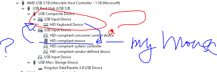

Hi Slender, I hope you can help me out with this. I started resetting the mouse using the method from the link you posted. It works initially but comes back very quickly and the input lag comes back again. I'm having a little bit of trouble comprehending the steps you posted in your method. I have a Razer Viper V2 PRO and it's difficult to compare what I'm seeing to your guide. Can you help? I attached 2 snips. My mouse directory stemming from the usb controller and a snip of my 'Mice and other point devices' directory and keyboard directory. Can you let me know what I'm supposed to disable?
I already cleared devices from the device removal tool.
