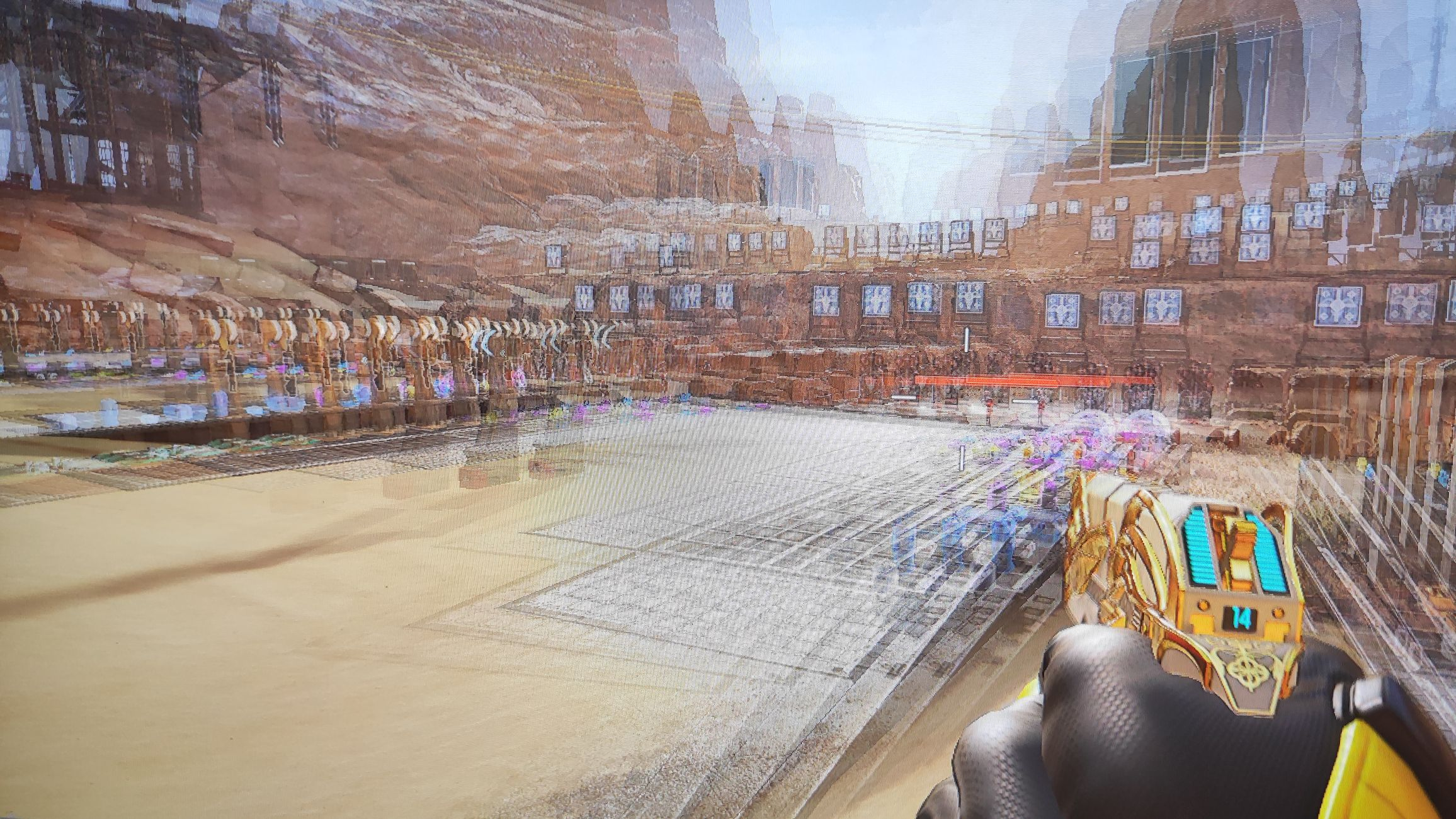

I bought this monitor 3 days ago. Im having insane amount of ghosting when playing on 240hz. When I change to 60hz ghosting drastically reduces. How can I fix this and is this monitor or gpu problem?

I have VRR turned off. The instrutions link doesn't work but I think I've made good photo.
During stationary gaze I see alot of ghosting, but when I track moving objects I still see it, and it looks like Stroboscopic Effect of Finite Frame Rates, but it shouldn't be that bad I think.
Also when I move my mouse all textures smear, it looks like pixel response is too low and pixels are changing color too slow.
I use lowest overdrive setting - fast. There is super fast and extreme but these create big overshoot. Using warm colors didn't improve.

Did you mean during stationary gaze u see a lot of duplicate images (stroboscopic effect), but when u track u see smeared trail (ghosting)?
Footage shows monitor is working fine. I think you're sensitive to stroboscopic effect, meaning you're a stationary gaze type player. I'm afraid there is not much u can do. Even motion blur reduction won't be very beneficial. You could try it but this monitor doesn't have such feature.
Feel free to enable VRR. There is no reason to have it disabled. It might help a little bit.
