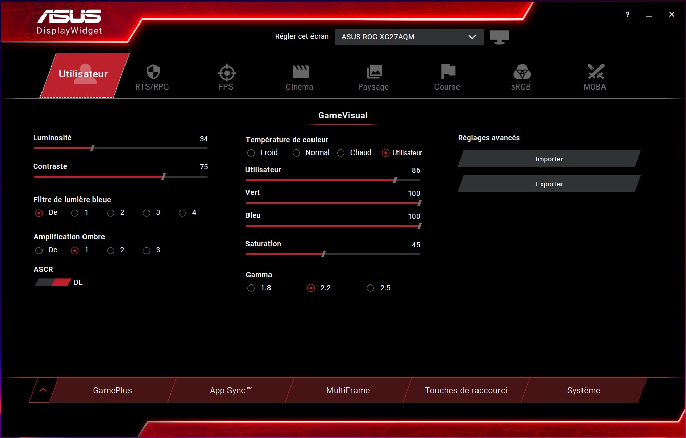

Hey,
Thank you for all those precious infos since that thread has opened.
I installed recently the "drivers" from Asus webpage, a zip file that I've used from the device manager where my monitor was seen as a standard Monitor plug and play, thus that Zip file had a .icm profile "Asus xxxx D6500", it got put by default and the color are now terrible...
The reds are over saturated, the sRGB is even worse than it was, it's globaly kinda cold (I have to use the "warm" preset to reblance the whites that are explosive, even at 30 brithness e.g. screenshot).
Anyway, i've deleted the profile from the windows color manager, but it statyed and I do not know which original profile I need to use instead to get back to the original colors that were a bit washed out but, at least, not eyes killing ...
Also, I was, for a year or so, in 8 bits, I've switched to 10 bits recently, and on those blur busters benchmarks, I am seeing some stutters at high speed (I didnt overclock it, it is @240hz). Is it a normal behaviour ?
Thank you guys

TeKamine
- Posts: 11
- Joined: 24 Sep 2021, 05:54
Re: Asus RoG Strix XG27AQM
It happens to me as well without sync on, switching from 60 To 120 here : https://www.testufo.com/stutter#demo=sl ... 00&pps=720ptuga wrote: ↑18 Jun 2022, 12:45Anyone tried 60fps lock with adaptive sync on? The refresh rate keeps jumping between 60 and 120 causing stutter. This happens with everything not just games. Even watching a 60fps video with mpv causes it.

I noticed that issue since i've installed the drivers and/or the Asus display widget, had no issues before.
Besides, some softwares were creating systemic stuttering on every test : Evga precison X and NZXT Cam softwares, I turned them off and I was green again, without any stutters... I might come from Nvidia drivers ? or chrome itself ? Hard to say ...

TeKamine
- Posts: 11
Version : Version 4.0.0.145 (windows 11), I am still fighting with colors since I've installed the drivers (while I never used them since I bought the monitor last year... Decided to on Asus webpage here : https://rog.asus.com/fr/monitors/27-to- ... _download/
To check if there were any Icc/Icm profiles available, and yes, they did included with the drivers (.icm), since then, colors are horrendous and killing my eyes ... No way to turn back, I've deleted the profile on windows but it stays as it is anyway ..
If anyone knows where to find a decent icc profile, it would be great. The reds are the most annoying ones, being super vibrant even with 40% saturation and reds @80%...
Before installing the drivers, i was on sRGB (a bit pale and coldish but alright enough..). Now the sRGB is litteraly changing yellows into mustards/oranges, reds into candy/flashy red..
Need help
Thanks
Need help
Thanks
TeKamine
- Posts: 11
I just picked a icc profile from the Asus XG279AQ, it is "good enough" in sRGB than the native one delivered with drivers, just in case you have the same issues with that sRGB completly messed up
