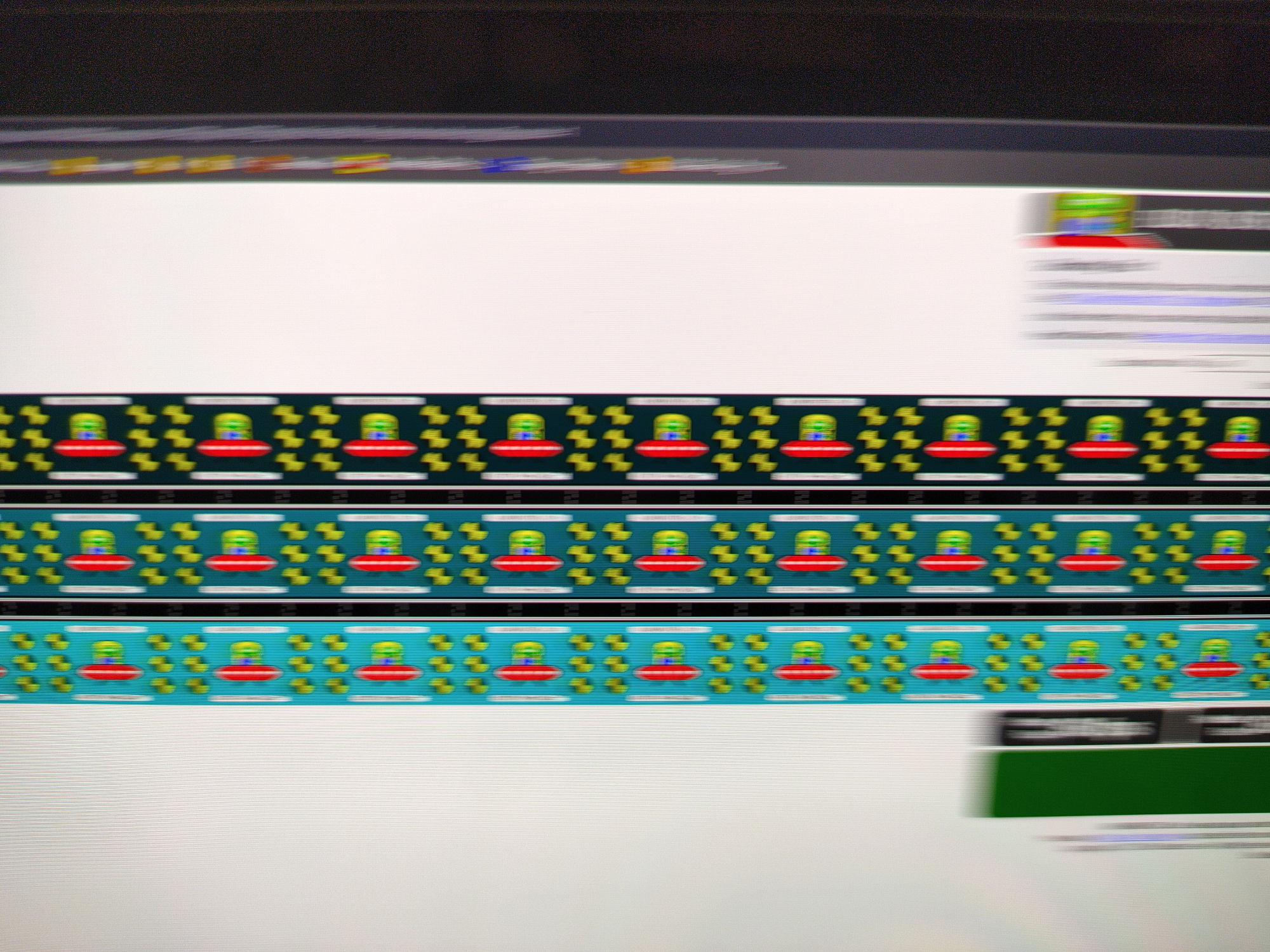

The 60hz display performs better on motion clarity than my LCD displays, but nothing like a tube and likely nothing like the big brother 120hz tv's and ultrawide OLED monitors available today. Photos below but I would caution you that with such a small and high resolution display focus was a major factor and real life performance far exceeds what you will see below. I would say it is closer to a 75hz display than the fairly average 60hz looking LCD like performance you see below. One benefit is that it has no overdrive and no over-shoot when it comes to motion blur so if you are like me and find overshoot absolutely intolerable at any level you will be satisfied.

(Below) Is a pair of pursuit camera shots taken at 1/20th exposure. Remember this is a tiny 4k display running without resolution scaling on. These were very difficult to take and IMO do not match real world eye tracking performance. They are both out of focus but over 2 hours of trying this was as good as I could get.

(Below) The second pursuit cam in the FrogTest Normally I wouldn't post this here but due to sheer luck it turned out better than the UFO one.

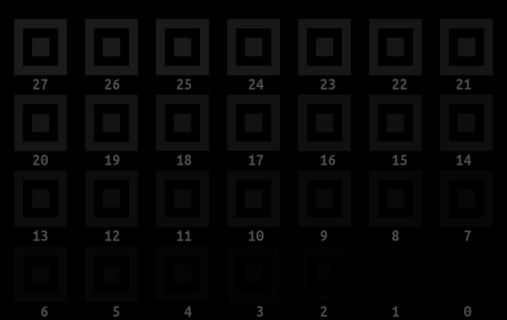

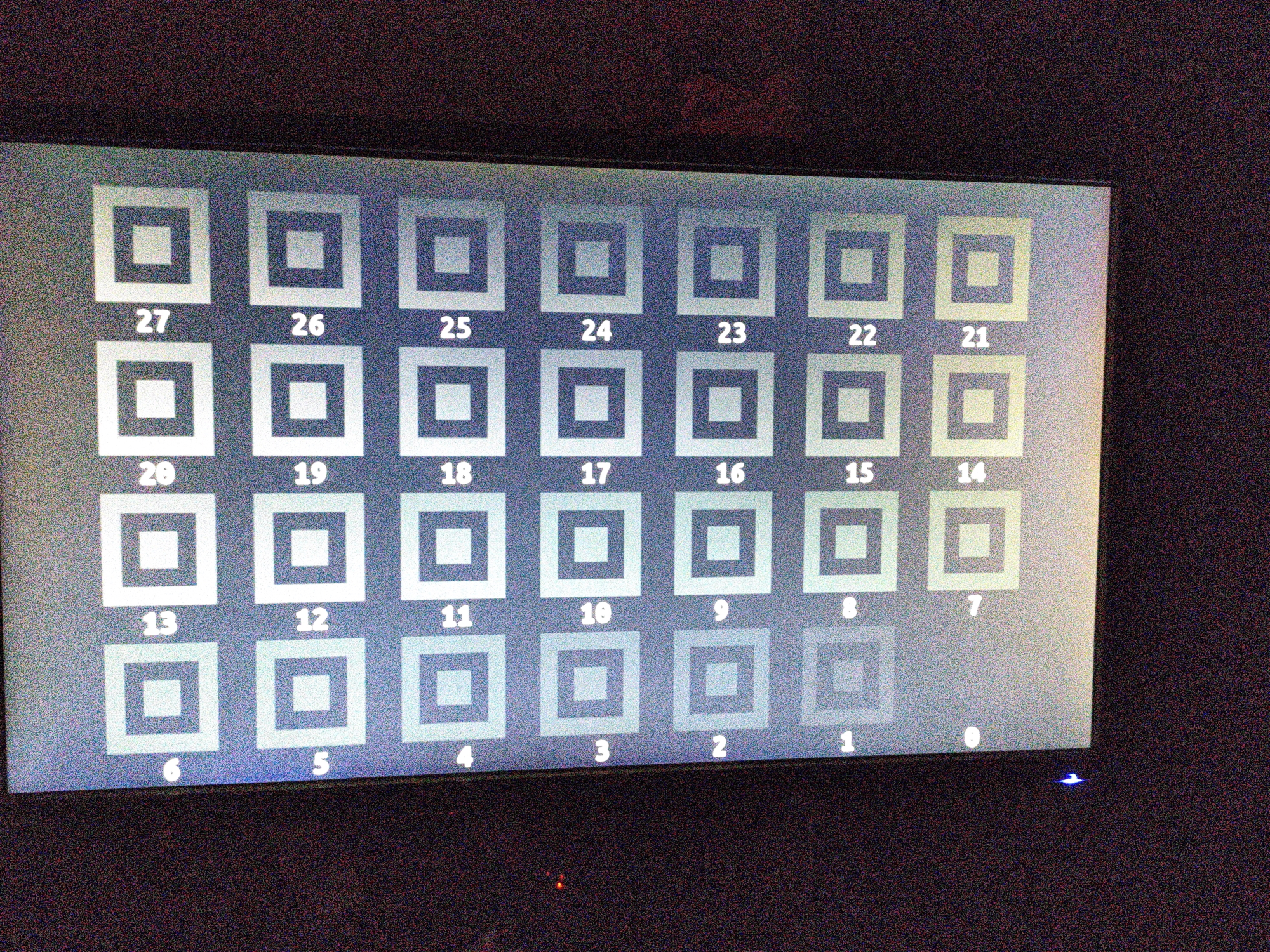

There was one issue with the monitor. Black crushing. As you can imagine such tiny OLED elements use nanoscopic power levels and I suspected if I tested gamma in a torture black test I could get some poor results. I was surprised with how well it did but you can see for yourself.
(Below) is a max ISO image to show the black falloff on the OLED:
OLED Gamma.jpg (4.36 MiB) Viewed 35773 times
(Below) Here is my cheap secondary LCD monitor.
LCD Gamma.jpg (4.82 MiB) Viewed 35773 times

(Below) is the reference image:
In practice none of this "black crushing" really mattered.
