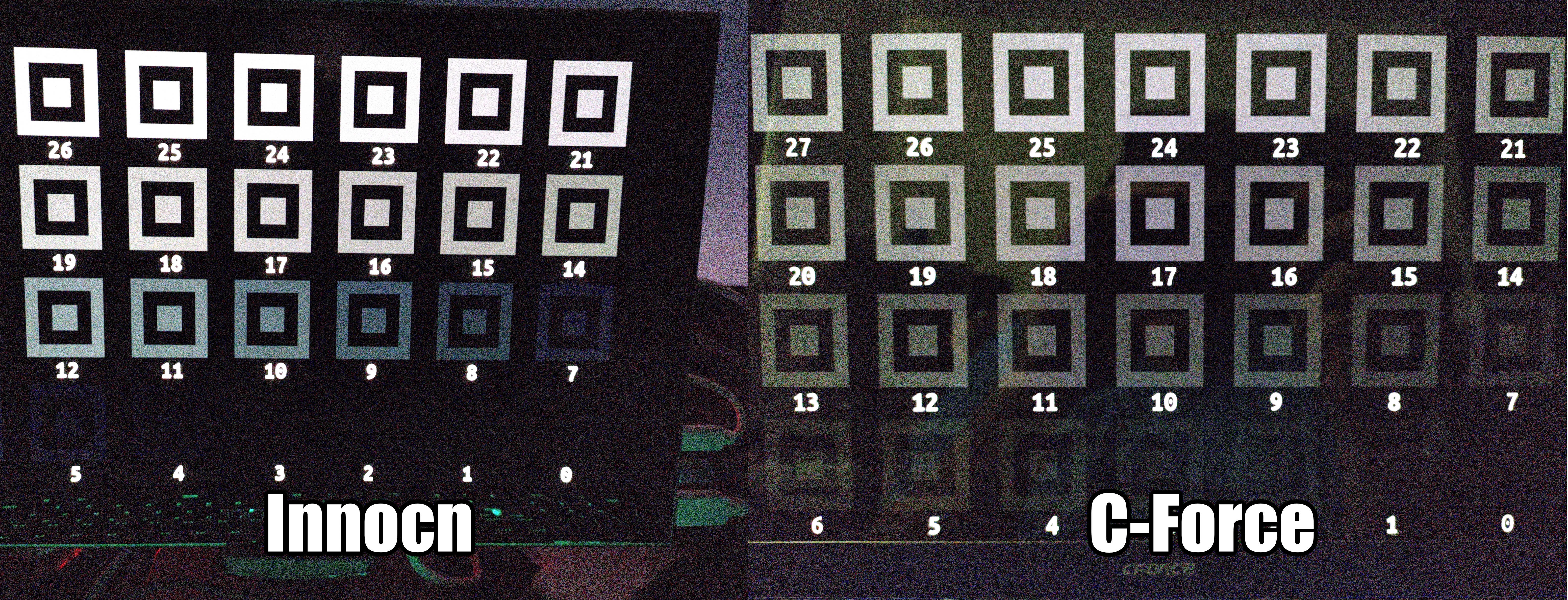

One of the only english youtube reviews I could find complained that there was only brightness control and no OSD. I found out this is actually misinformation. The little brightness/volume knob has a hidden feature, that much like R3/L3 on a controller is hidden under the joystick, if you press this little volume knob you get a menu and IN this menu you can control all the features you would expect to see on a normal monitor INCLUDING the baseline voltage level for the panel, labled "black level" this allows you to control the contrast at the bottom end, deciding for yourself where the black cutoff is, and completely eliminate crushing or even simulate a LCD display by bringing black up into the gray range without effecting the peak brightness! (this may appeal to professional artists)
Forgive the camera color temp difference, I did not adjust for white balance, also it was day time when I took the C-Force image introducing more reflection. The important part is you can clearly see where the C-Force after some adjustment makes it all the way down to 1, where the Innocn cuts off after 5. Tese images have been excessively boosted from the original to show the cutoff.
