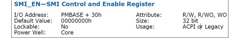

Stumbled across this https://youtu.be/cLKHb7DwtEk
Seems quite similar to what I’m experiencing. I can still, with synapse now on my gaming rig, force the cursor to stutter with app open, the instant dpi is changed. Still resolved by changing polling in app, and then once again changing dpi after will cause stutters.
I’m going to test forcing cpu to 50-99%, then playing with priorities whilst the cursor has been affected by the cpu change to observe any additional negative effects or improvements.
It may be worth noting I am also on coffee lake architecture and a z390 chipset.
