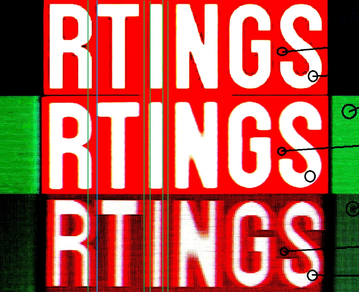

Anonymous316387 wrote: and YES ! i found that very blurry ! it's not that bad when we see these images but in practice it's worst.
and i can take ALL IPS of the website, you clearly see that IPS have always a larger text on the logo, because in reality the "RTINGS" logo on their moving picture test are thin, generally, all TN always have a thinner text, so the ghosting and the persistence of the image are bigger on IPS ( and also VA, but i don't care about VA technology )

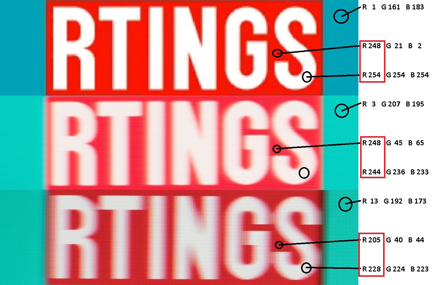

To begin with, let's take a video close to the rtings benchmark and cut out a piece for comparison. https://www.youtube.com/watch?v=JW1IUiVknwI
"rtings reference" "pg279qm 240" "vg248qe 144"
These are images for visualization. There is no precision in them!
Most tn on the market except for professional photo editing monitors. They cannot convey red and other colors in the reference form.Especially in transitions 0-255.
Instead of R255 G0 B0 we get ~R225 G0 B0. The red becomes darker. These are panel errors.
The contrast between white R 255 G 255 B 255 and red R255 G0 B0 is lower than between white R 255 G 255 B 255 and burgundy R128 G0 B 0.
The image appears sharper and objects are easier to recognize when the contrast is higher. But it has nothing to do with motion blur.
With the help of a colorimeter and a color profile, you can easily transfer colors from vg248qe to pg279qm.
There is no problem to lower the value from R248 to R205. If this color suits you better.
Anonymous316387 wrote: all TN always have a thinner text
Next, I will try to show exactly where the blur occurs. But such a comparison method is not correct and should not be used to compare test images.
This is nothing more than a visualization. https://youtu.be/RyyBFZ2hBZM
It should be very clear how blurry the text is. And why are the letters thin.
