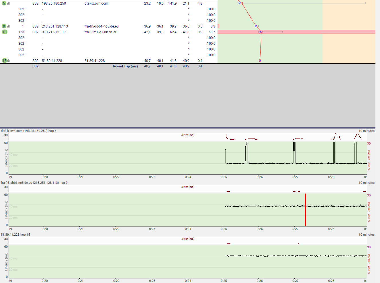

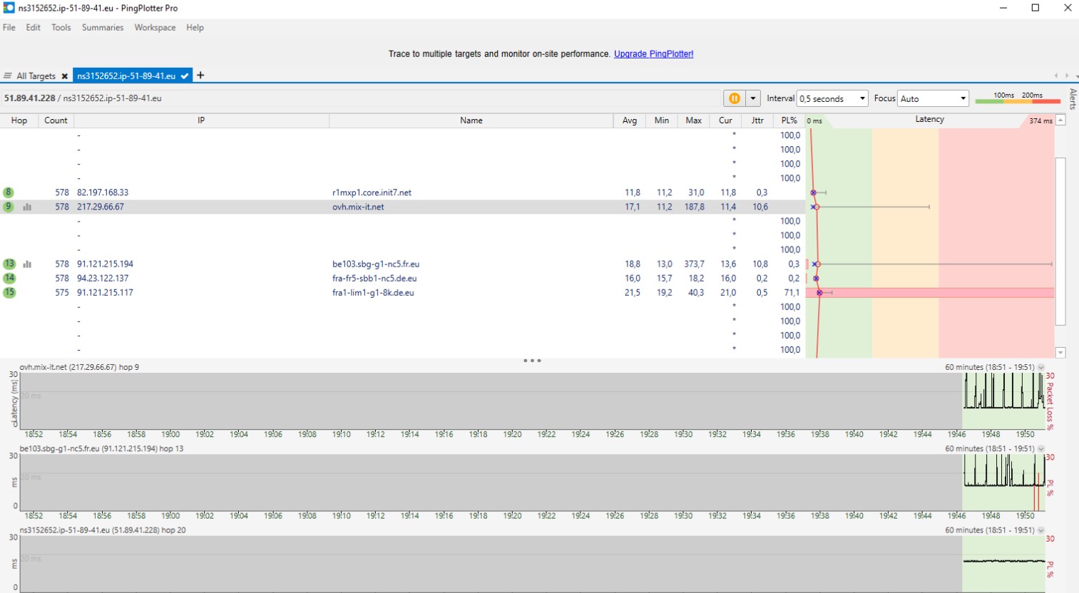

Yo tiplese can you pingplot me this Faceitserver: 51.89.41.228
Nothing in ICMP graph looks bad, same in netgraph
