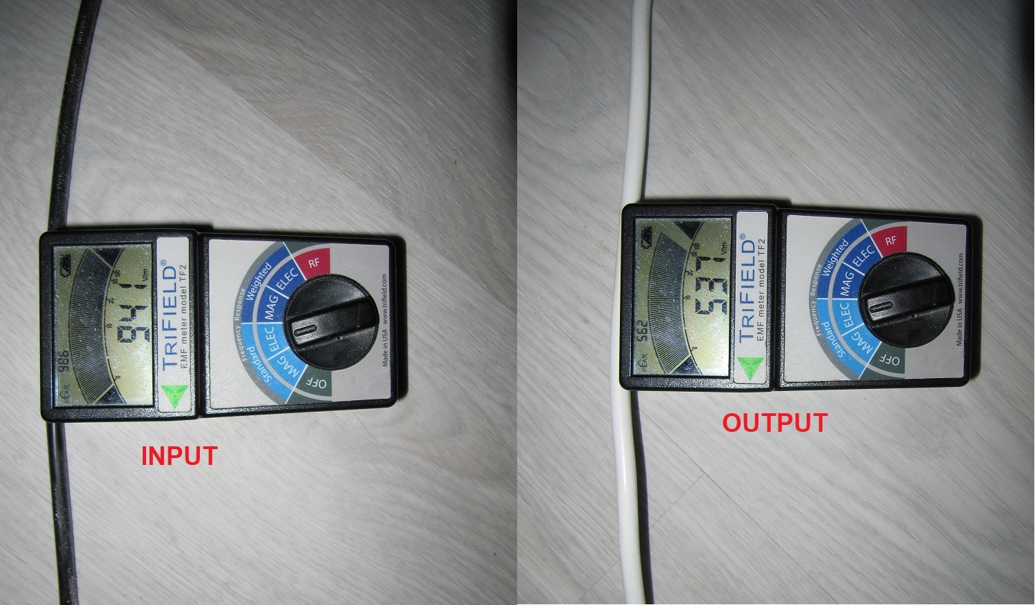

Part 2: The results
- ELECTRIC FIELD
- Electric.jpg (463.17 KiB) Viewed 10197 times

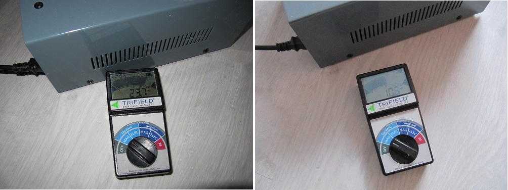

- MAGNETIC FIELD
- magpic.jpg (122.59 KiB) Viewed 10197 times

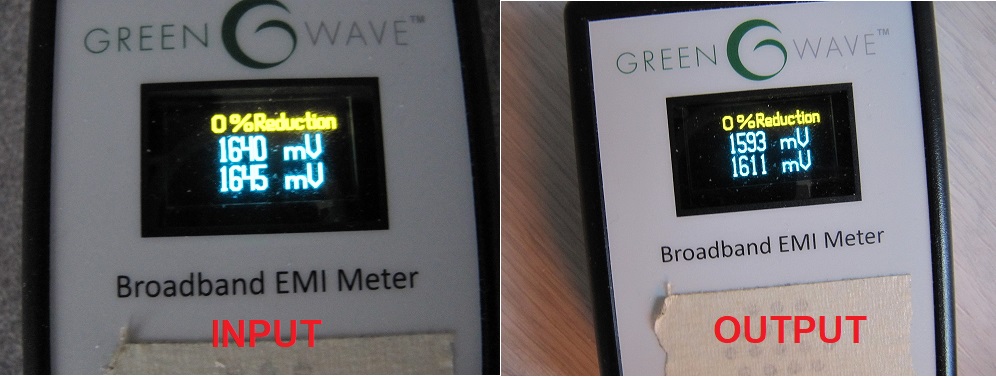

- EMI
- emipic.jpg (122.79 KiB) Viewed 10197 times

Explanation of the pictures:
Electric fields: Input 941 V/m, output 537 V/m. Electric fields cancel each other = 0 V/m in theory, but not in practice. Yet it is much lower, because they somewhat cancel each other fields.
Magnetic fields: Magnetic field 23.7 milliGauss and a further way 10.6 milliGauss. Low magnetic fields, but still I do not put this near my computer, power strip or me.
EMI: Input 1640 mV and output 1593 mV picture. Not much effect on EMI (3kHz-10 MHz). I have only this EMI noise meter. To get more accurate status you would need to have an oscilloscope, to see what changes and how much.
