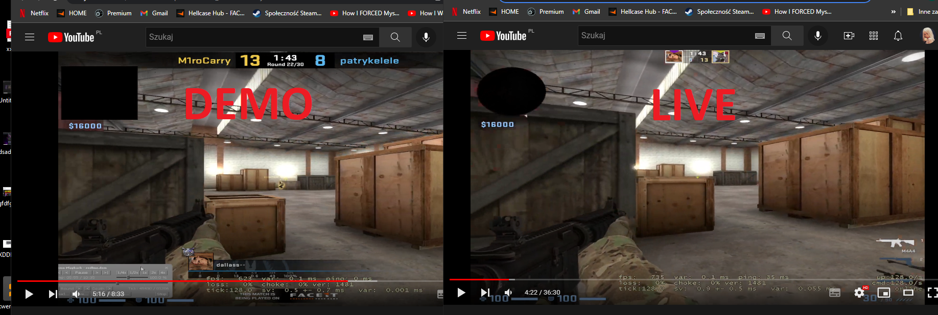

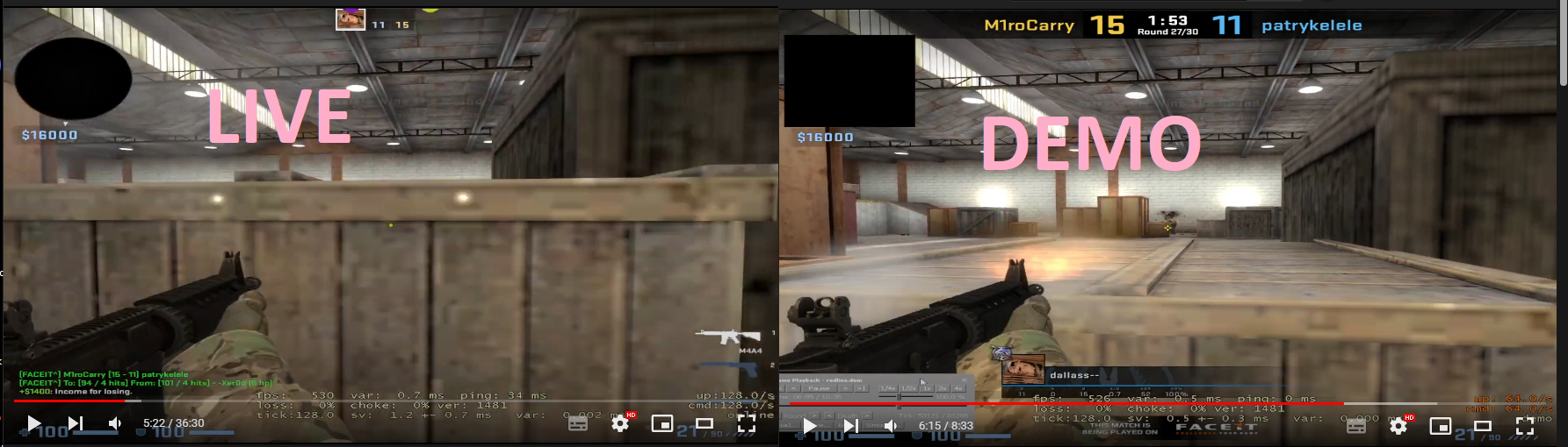

The ups, seems to doesn't work as it should. I have no idea how to test problem . Last time i livestream my 1vs1 games on twitch, after that i download demo and compare it to each other. I was shocked when i saw it. Many times i am behind box but ppl keep killing me. Now i know why. I the same frame my character was in other possition other than on demo. I notice also after changing pre-rendered frames from value "1" to "Use the 3D application settings" it felt much better.

- kurwa.PNG (1.16 MiB) Viewed 3218 times
- csgo.PNG (1.17 MiB) Viewed 3218 times
