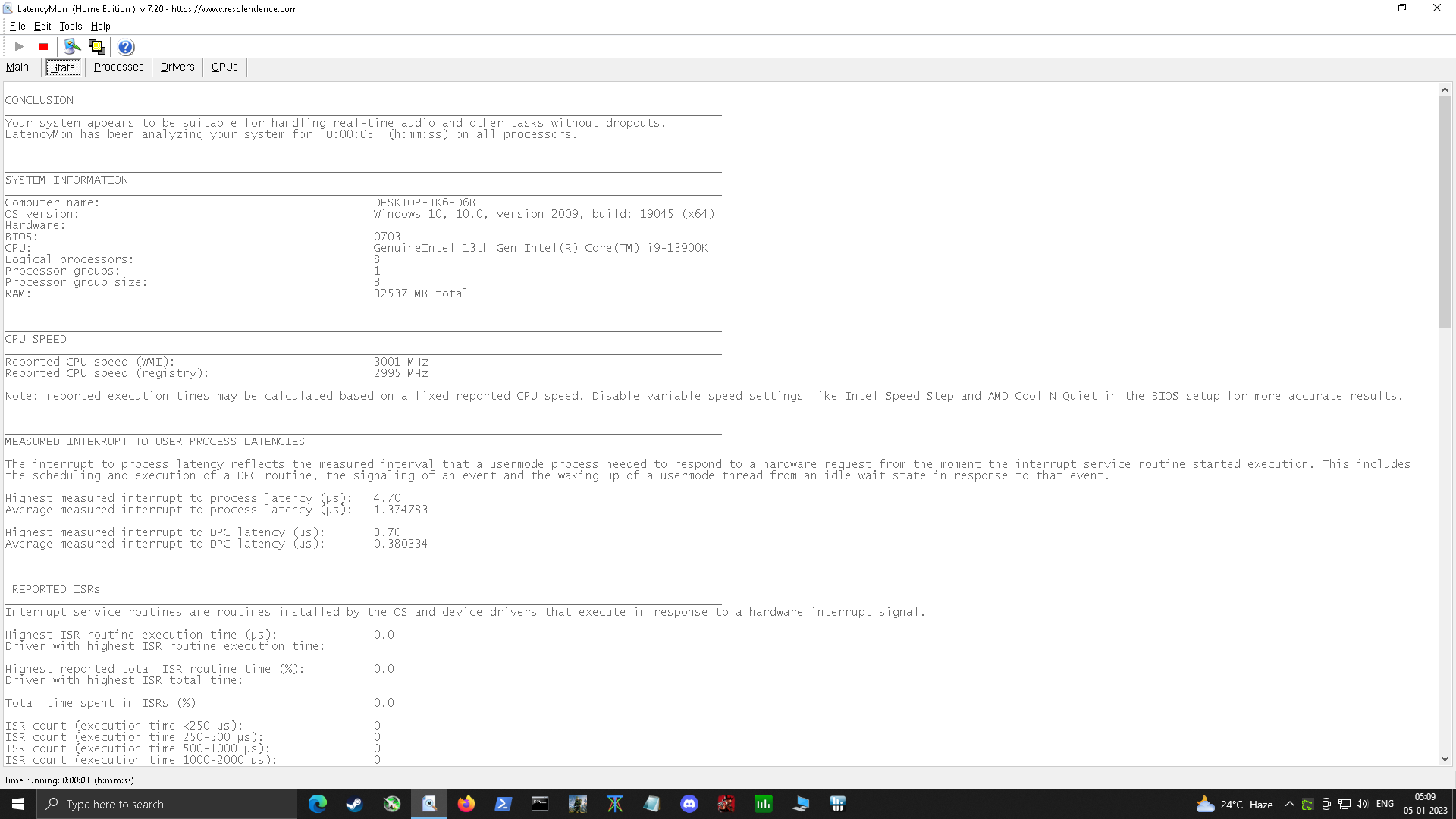

Tuhin Lavania
Posts: 69
Joined: 21 Feb 2022, 09:26
Re: Ryzen vs Intel Input Lag/Latency
Post by Tuhin Lavania » 07 Jan 2023, 13:04
This is on Intel.
This is the lowest i can go. I cant find any tweaks that will help the latency to go lower.
On AMD i was on 0.52-0.53 avg.
FPSMaster
Posts: 189
Joined: 04 Jun 2021, 20:39
Post by FPSMaster » 07 Jan 2023, 13:25
Tuhin Lavania wrote: ↑
07 Jan 2023, 13:04
This is on Intel.
These results are self explaining given the fact your AMD System cant keep up performance wise with your intel System, due to better and more expensive CPU and better ram!
Tuhin Lavania
Posts: 69
Post by Tuhin Lavania » 07 Jan 2023, 13:30
Its a well-known fact that AMD systems have higher latency than Intel.
Even by disabling one CCX on the 5950X i couldnt bring down the dpc latency like Intel on AMD.
