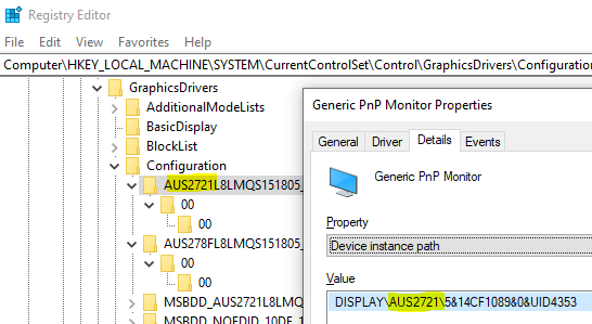

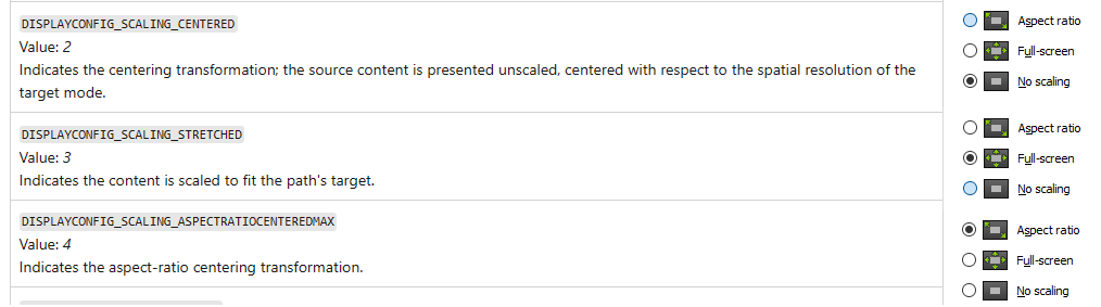

Regarding fullscreen, aspect ratio, no scaling (centered)
Reference:
https://learn.microsoft.com/en-us/windo ... ig_scaling
https://learn.microsoft.com/en-us/windo ... ktop-image
How Nvidia control panel scaling setting maps to Windows scaling
Registry setting that changes:
HKEY_LOCAL_MACHINE\SYSTEM\CurrentControlSet\Control\GraphicsDrivers\Configuration\<monitordeviceinstancepath>\00\00\Scaling = X
