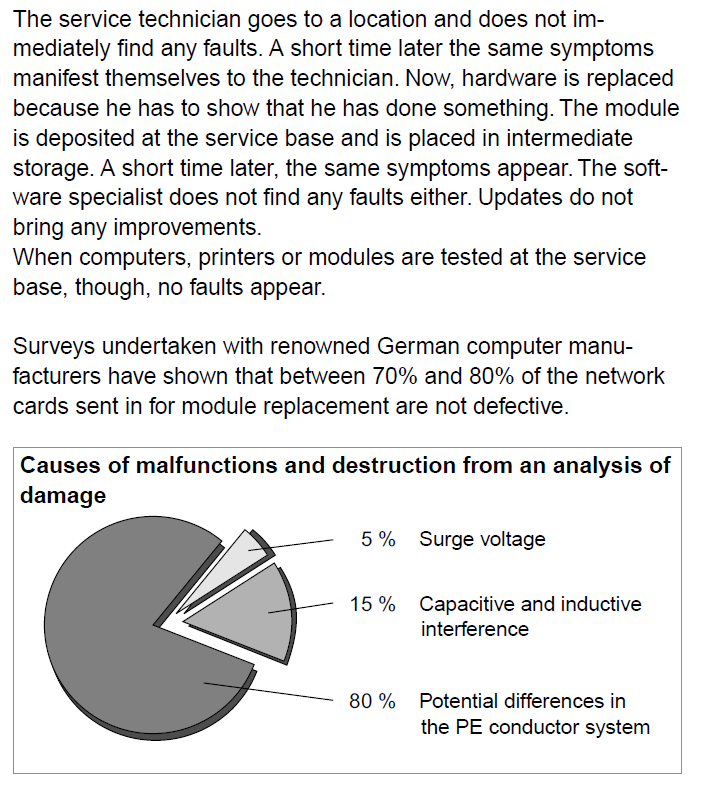

I disagree, you should always plug grounded things (e.g. computers) to the grounded outlet.
If you don't connect some of the leakage currents (e.g. EMI filters), start circulating between all the wires in the computer.
"Switched-mode power supply (SMPS) typically used in
personal computers, laser printers, and other equipment.
Here the DC ground of the SMPS output is referenced to
the protective earth (PE) conductor of the mains via the
SMPS chassis. This direct link, therefore, acts as a sense
conductor, establishing the PE voltage as the local DC
ground potential."
Ground (PE) is also used as a voltage reference, which should not vary.

- Faults.png (72.16 KiB) Viewed 6888 times

Actually it's not, as cybepine mentioned, most newer microchip containing electronics have EMI Filters in them and in order for that filter to function properly and within specs & EMC Standards it needs a ground line. It's true that the number one reason for grounding is safety, yet it doesn't mean it's the sole reason.
